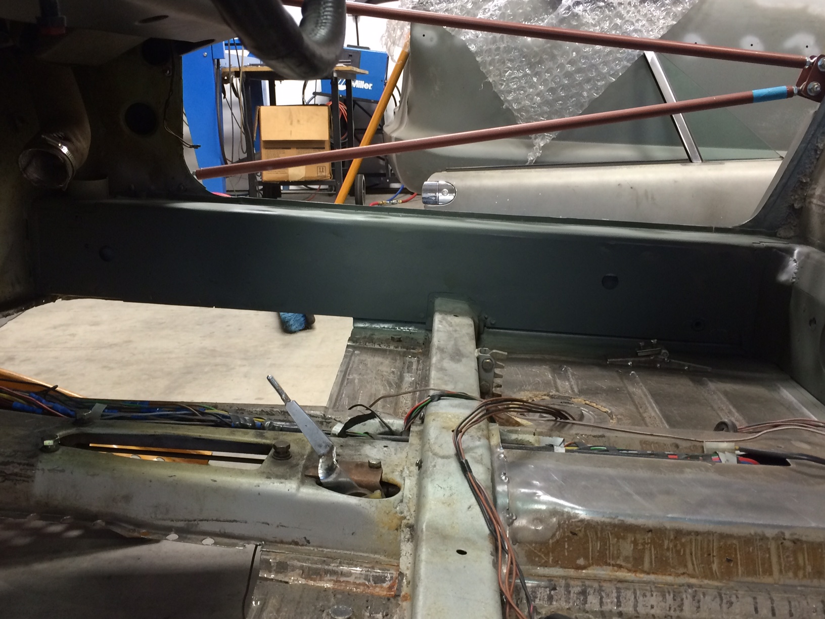

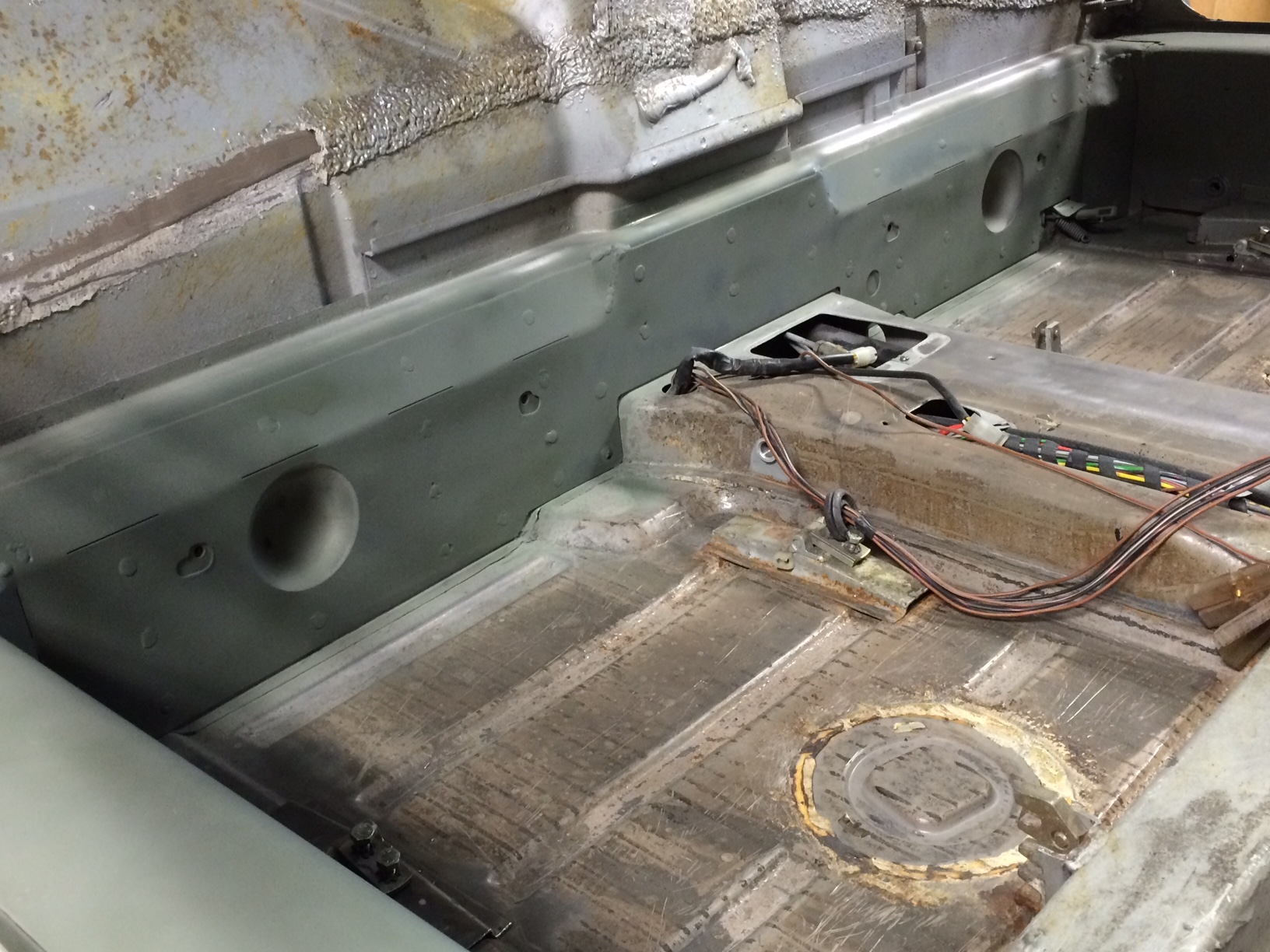

More boring stuff for - Long stiffener kit is in!
I found it very therapeutic as I worked through the whole "remove a sheet metal screw, spot weld, cool with compressed air, move to the other side and do it again". Took my time, did the welding over 3 days and checked the door measurements 4-5 times as I went. I even pulled the braces and put the door back on when I was about 1/2 way through, just to be sure.
All the advice given on this forum is spot on and my doors fit just like they did before I started this improvement!
I didn't think it would be a problem if I didn't grind the welds all the way down on the rear section.
