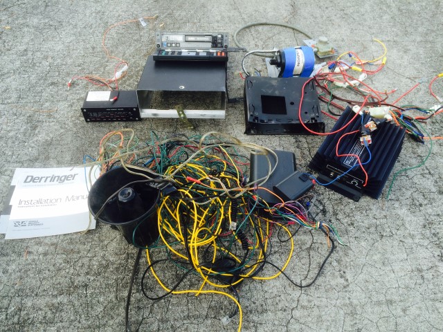

Then I started in on the wiring mess, removing the 30y.o. alarm system, the awful aftermarket stereo, amp, graphic eq, and speakers, the dash-mounted voltage meter (mounted in the stock radio location with a 2-hole meter pod - and one hole left open!) and the associated rats nest of wiring. (separate post Premo PO wiring ...nightmare!)
