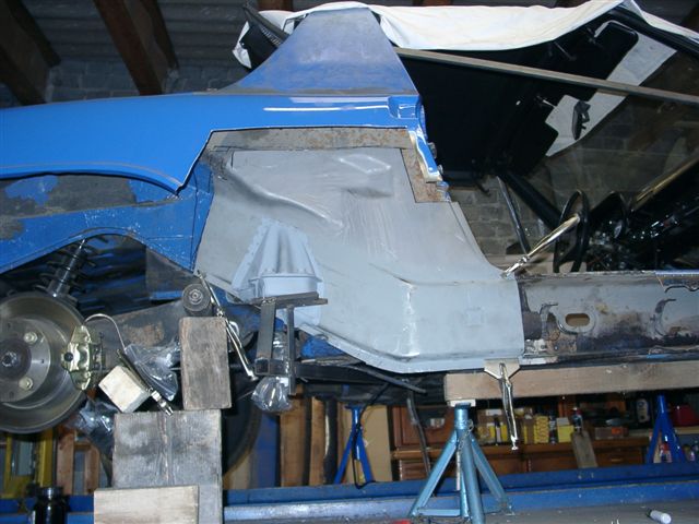

The story goes on, ....slowly but steady (IMG:style_emoticons/default/smile.gif) .
Did some cleaning and fitting the repair panel into the hole.
The suspensionconsole is fresh sandblasted and primed.
It is a little tricky to find the right position for the repair panel, because its position is realy important to find the right position for the suspension console.

michelko   during study i worked one day per week in an metal...   Sep 18 2004, 11:24 AM

michelko   Hi Special_K "how do you say "You've got ball...   Sep 18 2004, 03:12 PM

SpecialK   I don't know about michelko, but I'd "weld...   Sep 19 2004, 01:38 AM
trojanhorsepower   I am not worthy :worship: How did you bend the m...   Sep 19 2004, 07:28 AM
michelko   I use rustconverter (fertan) on all old stuff and ...   Sep 20 2004, 04:09 AM
