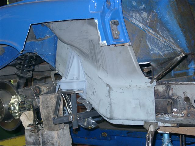

Hi guys,
look what i found under the fender. The PO did some very fine work to repair the hell hole (IMG:style_emoticons/default/ar15.gif)

michelko   here you can see the new metal. Think next weekend...   Sep 5 2004, 03:20 AM
michelko   Some advice to keep the door gap stable? I made a ...   Sep 5 2004, 03:23 AM

michelko   hi everybody, did some work on the rustbucket. Cut...   Sep 16 2004, 02:54 PM
michelko   Hold the new sheetmetal in place. looks very nice ...   Sep 16 2004, 02:56 PM
michelko   should add the pic ;)   Sep 16 2004, 02:56 PM
michelko   nother one   Sep 16 2004, 02:59 PM
michelko   inside of the console and the safetybelt mounting ...   Sep 16 2004, 03:02 PM
michelko   outside saturday will be weldingtime again :welde...   Sep 16 2004, 03:04 PM

michelko   And the story goes on. removed the batterytray tod...   Sep 18 2004, 09:50 AM
michelko   the firewall was also infected. The first replacem...   Sep 18 2004, 09:52 AM
michelko   wr   Sep 18 2004, 09:53 AM
michelko   thats for today. did i tell you that i hate rust? ...   Sep 18 2004, 09:56 AM

michelko   during study i worked one day per week in an metal...   Sep 18 2004, 11:24 AM

trojanhorsepower   I am not worthy :worship: How did you bend the m...   Sep 19 2004, 07:28 AM
michelko   I use rustconverter (fertan) on all old stuff and ...   Sep 20 2004, 04:09 AM

michelko   Here we go. Some progress pics. Fitted the outer r...   Sep 30 2004, 01:18 PM
michelko   blabal   Sep 30 2004, 01:19 PM
michelko   :wub:   Sep 30 2004, 01:20 PM
michelko   primed area 51   Sep 30 2004, 01:22 PM
michelko   front   Sep 30 2004, 01:23 PM
michelko   nother   Sep 30 2004, 01:24 PM
michelko   and the new parts   Sep 30 2004, 01:25 PM
michelko   can you count the number of paint jobs? :wacko:   Sep 30 2004, 01:26 PM
michelko   and some more new parts and a bottle of fuel :wooh...   Sep 30 2004, 01:53 PM
michelko   i also received last week engman´s stiffenig kit....   Sep 30 2004, 01:56 PM
