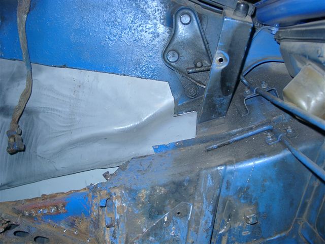

Hi guys,
look what i found under the fender. The PO did some very fine work to repair the hell hole (IMG:style_emoticons/default/ar15.gif)

from the inside

michelko   additional pic from inside of the long. Have to dr...   Sep 12 2004, 10:26 AM
