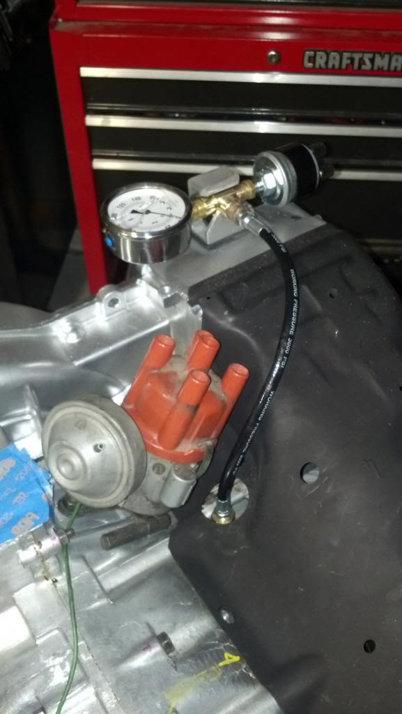

I've developed a leak at the oil pressure sender. However, I have a dual sender and a hose that goes from the sender to the location where the stock oil pressure switch screws into the case.
I'm guessing I need to get a new hose. Where do I get one of these with the correct threads for the sender switch location?

"Where do I get one of these with the correct threads for the sender switch location?"
I don't want to restart that argument, but there are some that believe that thread is actually metric.
I used a 10mm metric thread adapter to switch to 1/8NPT to screw my grease gun hose into.
You can see the adapter. It is the brass piece that is barely visible above the tin:
(IMG:http://www.914world.com/bbs2/uploads_offsite/i366.photobucket.com-10819-1450036163.1.jpg)
I believe this is the adapter I ordered:
https://www.pegasusautoracing.com/productde....asp?RecID=1832
Most just thread the grease gun hose 3/8" NPT right into the case and call it good.
