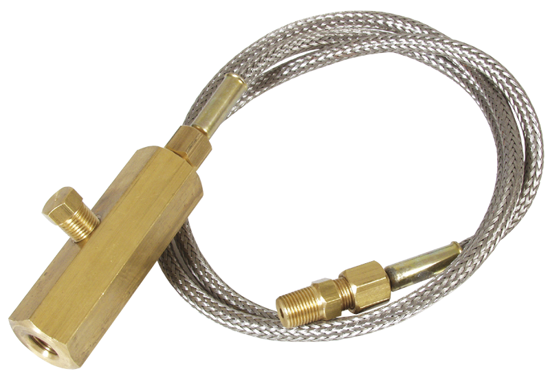

I've developed a leak at the oil pressure sender. However, I have a dual sender and a hose that goes from the sender to the location where the stock oil pressure switch screws into the case.
I'm guessing I need to get a new hose. Where do I get one of these with the correct threads for the sender switch location?

I use this, from a British vendor "LMA Performance"
Might not be viable for those in the US after factoring in shipping cost .
http://www.lmaautoparts.com/products/REMOTE_T-PIECE_KIT_M10/

76-914   Off of a grease gun.   Dec 13 2015, 08:54 AM
era vulgaris   For real? No mods to it, just plug and play?   Dec 13 2015, 08:56 AM
BeatNavy   I used AA's "kit": http://www.autoa...   Dec 13 2015, 09:00 AM
era vulgaris   I used AA's "kit": http://www.auto...   Dec 13 2015, 09:08 AM
cary   Rubber Grease Gun Hose. Hanging on a hook a NAPA.   Dec 13 2015, 09:47 AM
era vulgaris   Awesome, I'll pick one up today. Thanks guys...   Dec 13 2015, 09:49 AM

Bleyseng   I went to a Brake/Hydraulic hose Shop that makes a...   Dec 13 2015, 06:23 PM
era vulgaris   I went to a Brake/Hydraulic hose Shop that makes ...   Dec 13 2015, 07:52 PM

bdstone914   1982 928 rear caliper flex line. Bought one at O...   Dec 14 2015, 06:46 AM
era vulgaris   1982 928 rear caliper flex line. Bought one at ...   Dec 14 2015, 08:18 AM
blackmoon   I bought one for my sender at a local hotrod shop,...   Dec 14 2015, 11:20 AM
era vulgaris   I just ordered a 928 rear brake line. We'll s...   Dec 14 2015, 11:55 AM
BeatNavy   That's part of the reason I went and sprung fo...   Dec 14 2015, 11:59 AM

Al Meredith   You can use a Paint Ball gun braided hose.   Dec 14 2015, 12:46 PM
Brett W   What am I missing here, its a 10x1.0 BSP thread on...   Dec 14 2015, 01:41 PM
