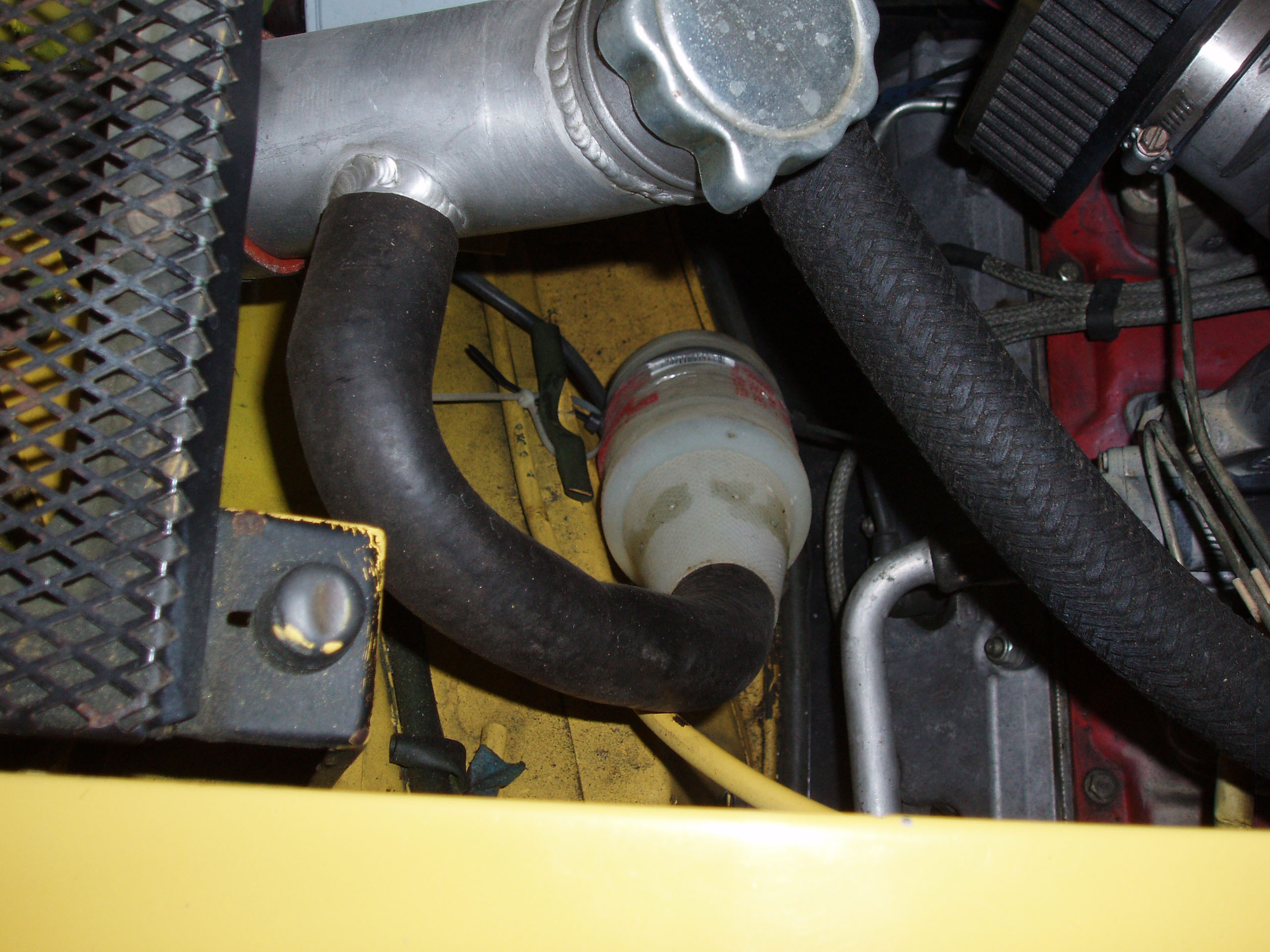

SirAndy   I used an old Gatorade bottle with a few holes dri...   Dec 16 2015, 12:26 PM

SirAndy   What's the part# on that gatorade bottle? :D...   Dec 16 2015, 01:40 PM

SirAndy   Has anyone ever puked up enough oil to catch anyth...   Dec 16 2015, 05:44 PM
