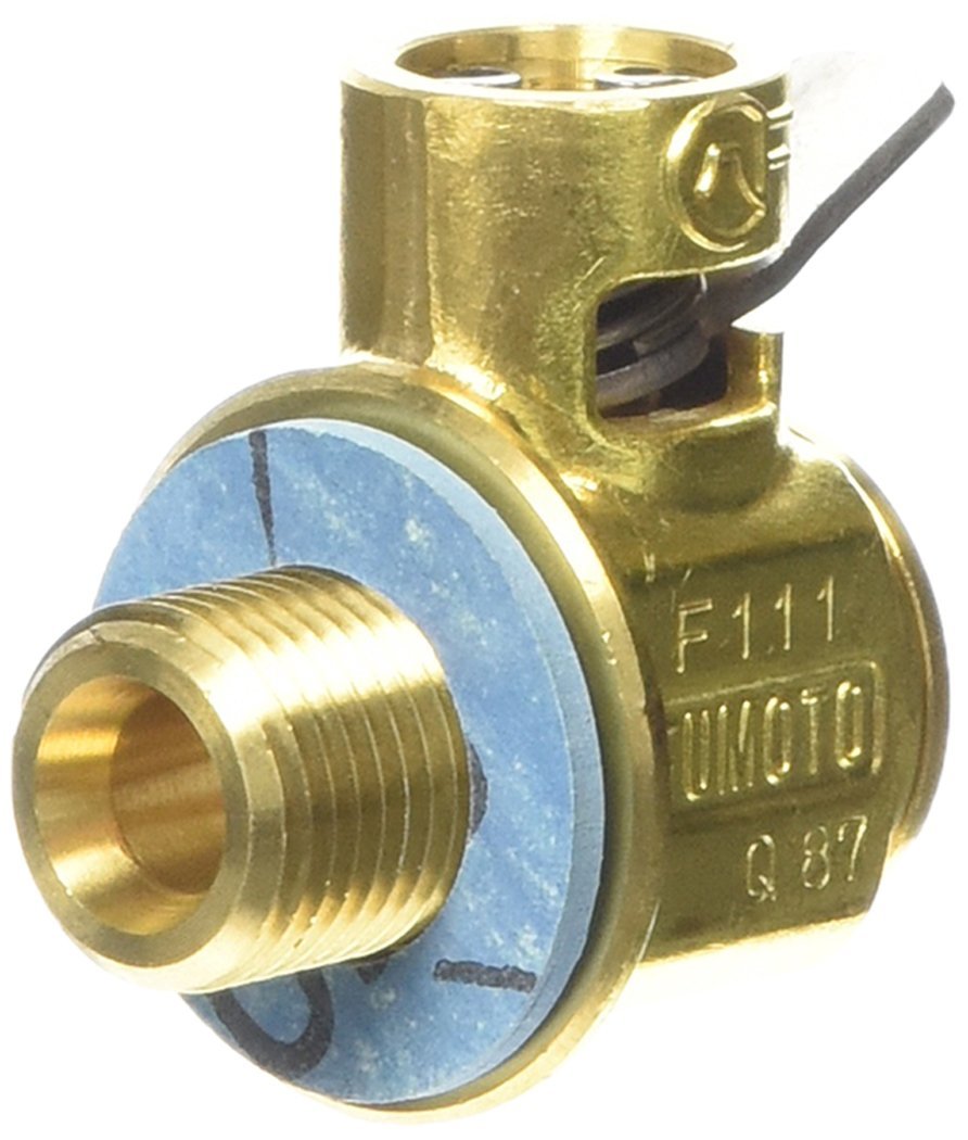

This is what I was thinking. I have one in my F250 and it's priceless:
(IMG:http://www.914world.com/bbs2/uploads_offsite/ecx.images-amazon.com-1110-1450396933.1.jpg)
