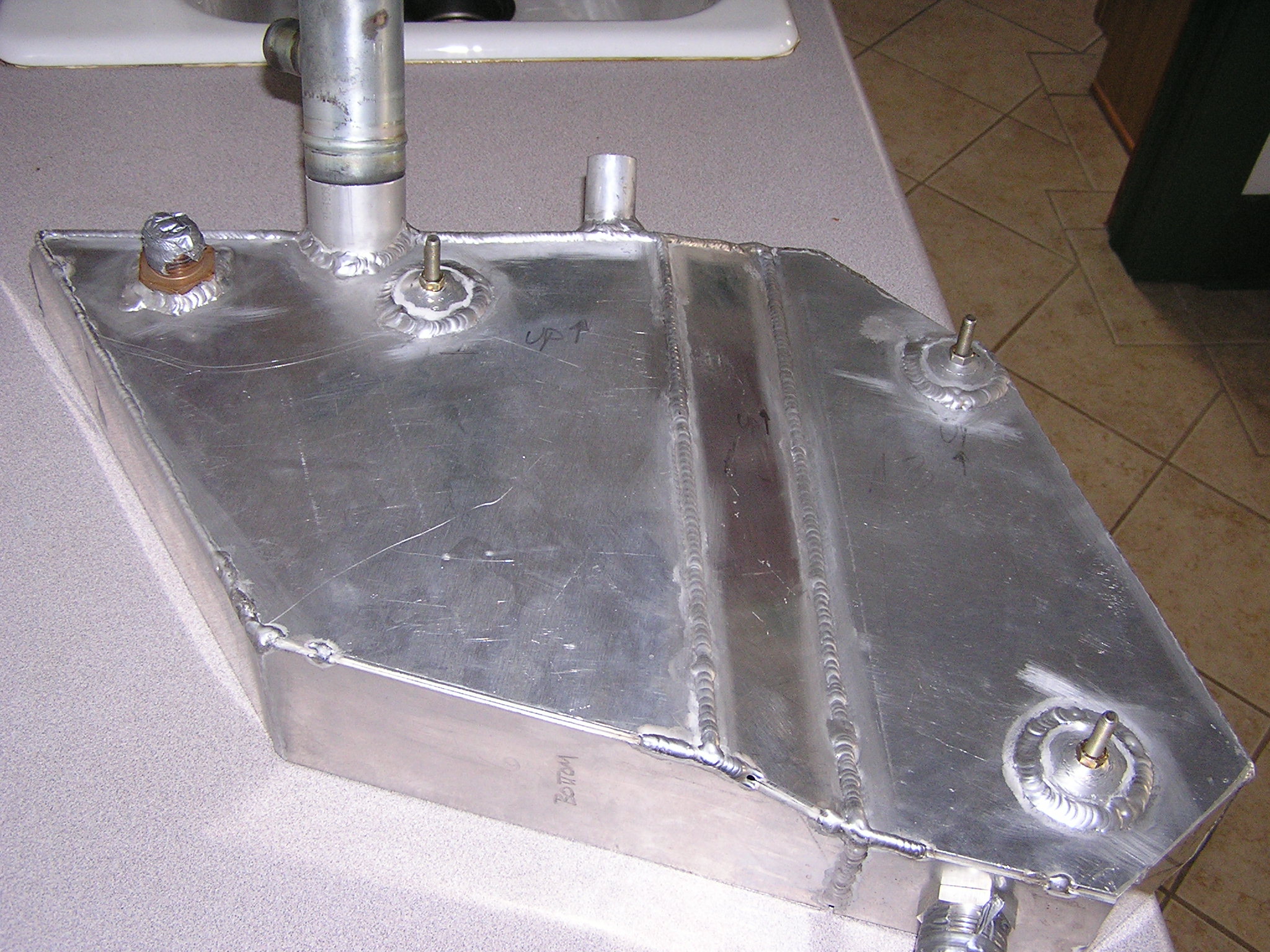

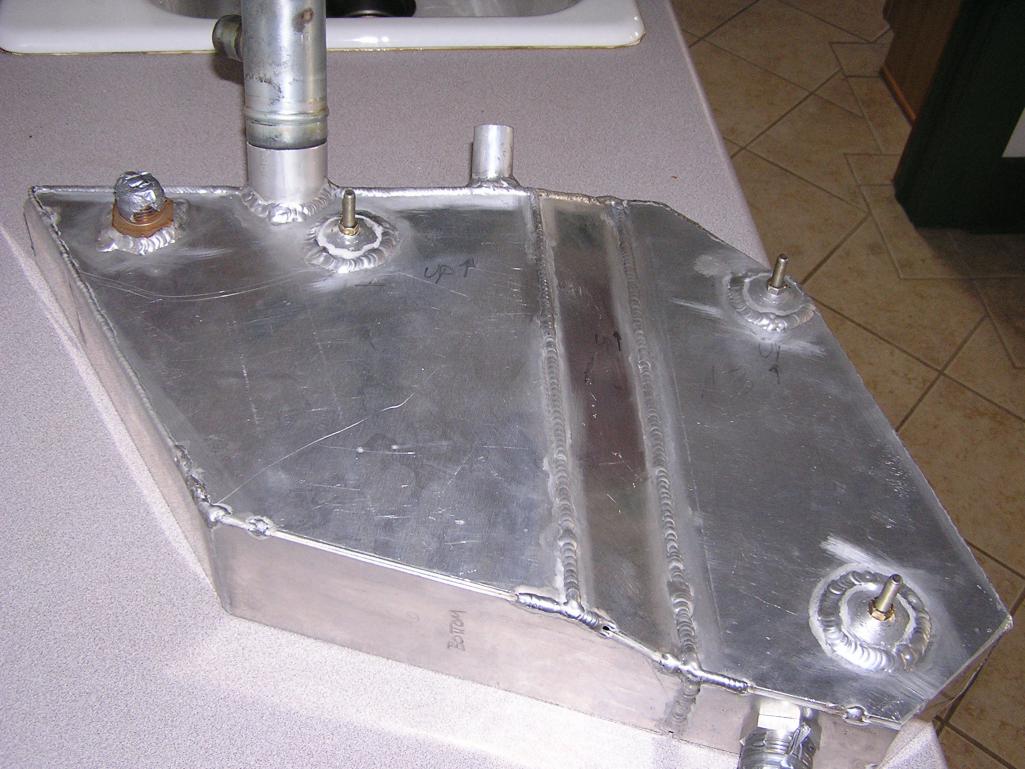

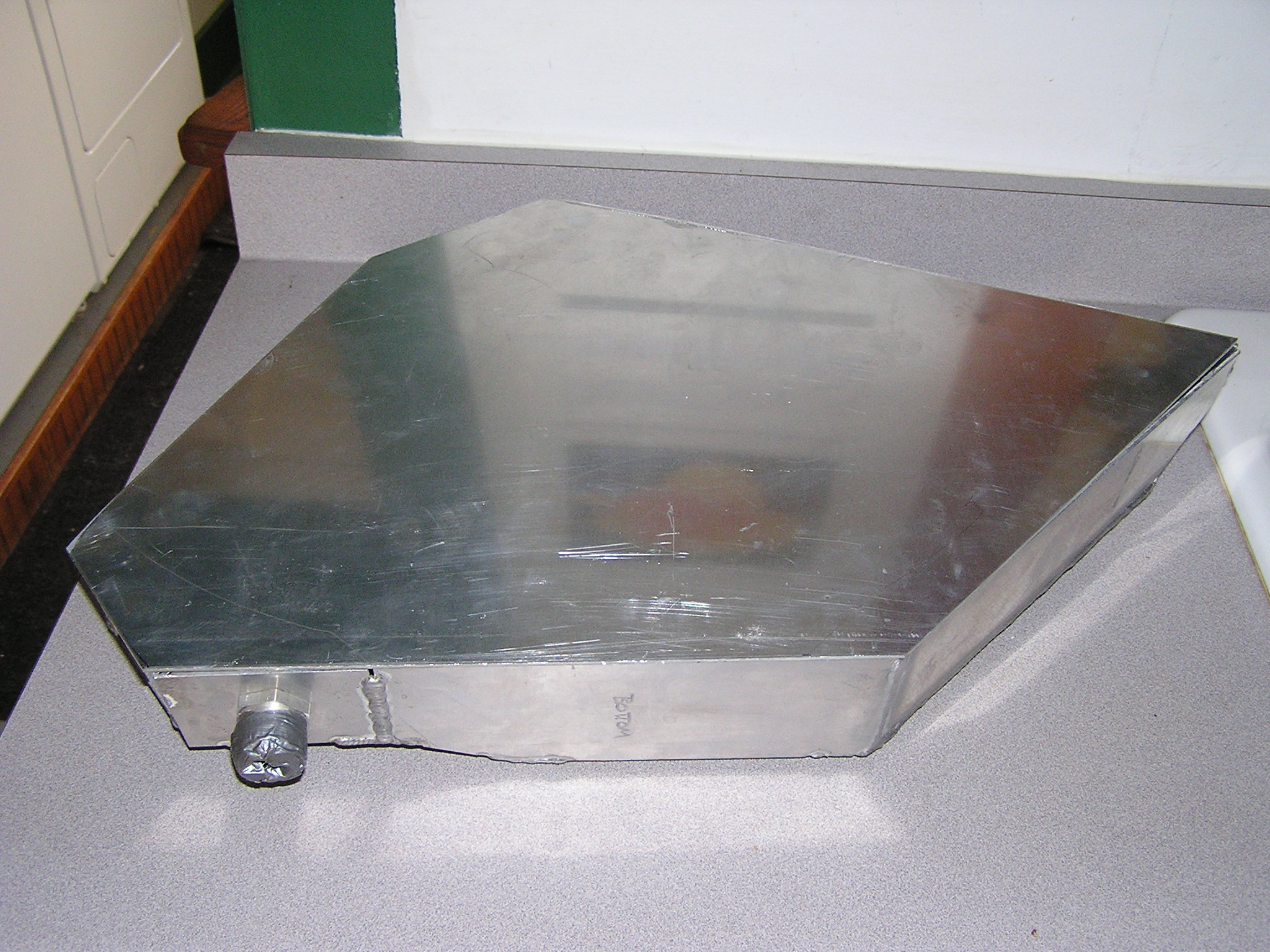

brant   pictures of the one I made about 8 years back.. a...   Dec 17 2015, 07:21 PM
brant   and   Dec 17 2015, 07:22 PM
brant   last:   Dec 17 2015, 07:23 PM
mb911   It's hard to tell from the picture but is that...   Dec 17 2015, 07:30 PM
brant   It's hard to tell from the picture but is tha...   Dec 17 2015, 07:57 PM
