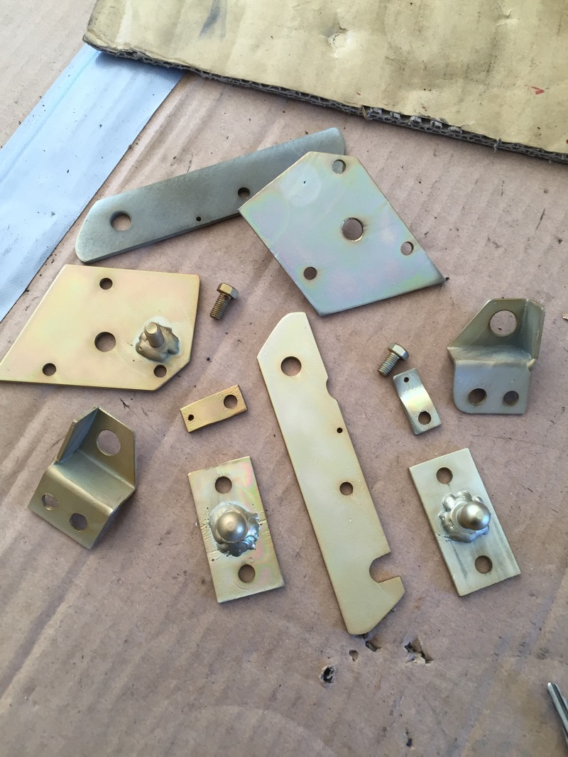

Managed to get a days work in last weekend and decided to fabricate a GT headlight mechanism - took about 8 hours to figure it out, cut, file, weld & zinc plate/passivate.
Works well... I used a motorbike throttle adapter for the 2 into one cable splitter& 10 kg gas struts...
