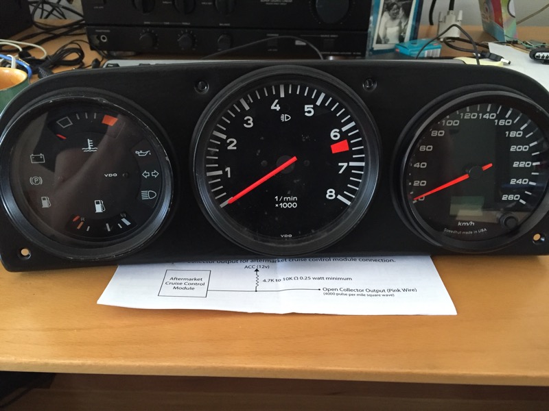

barrym   Managed to get a days work in last weekend and dec...   Dec 18 2015, 12:10 AM
barrym   Oh- and I repainted the cluster surround & ins...   Dec 18 2015, 12:29 AM
