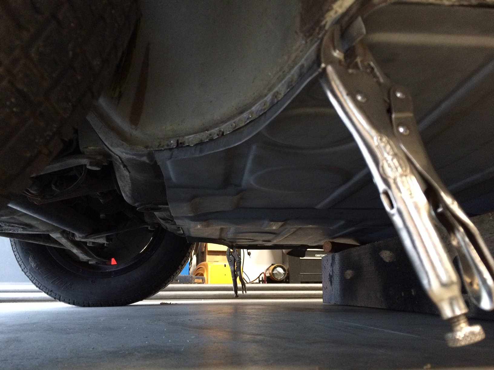

Got to working on fitting the front 1/2 floor panel. A buddy is bringing his track day 911 project over tomorrow and we're bending up his roll cage. I took my car off the stands in prep to move it and ended up having time to get the floor rough fit.
I was done before I really stopped to think I'd just done all this with the car on it's wheels and me working on the ground. What a dufus... (IMG:style_emoticons/default/blink.gif)
Oh well. It's fitting really nicely but I still have to do the final cuts on the front and rear of the original floor.
It'll be back on the stands for that!

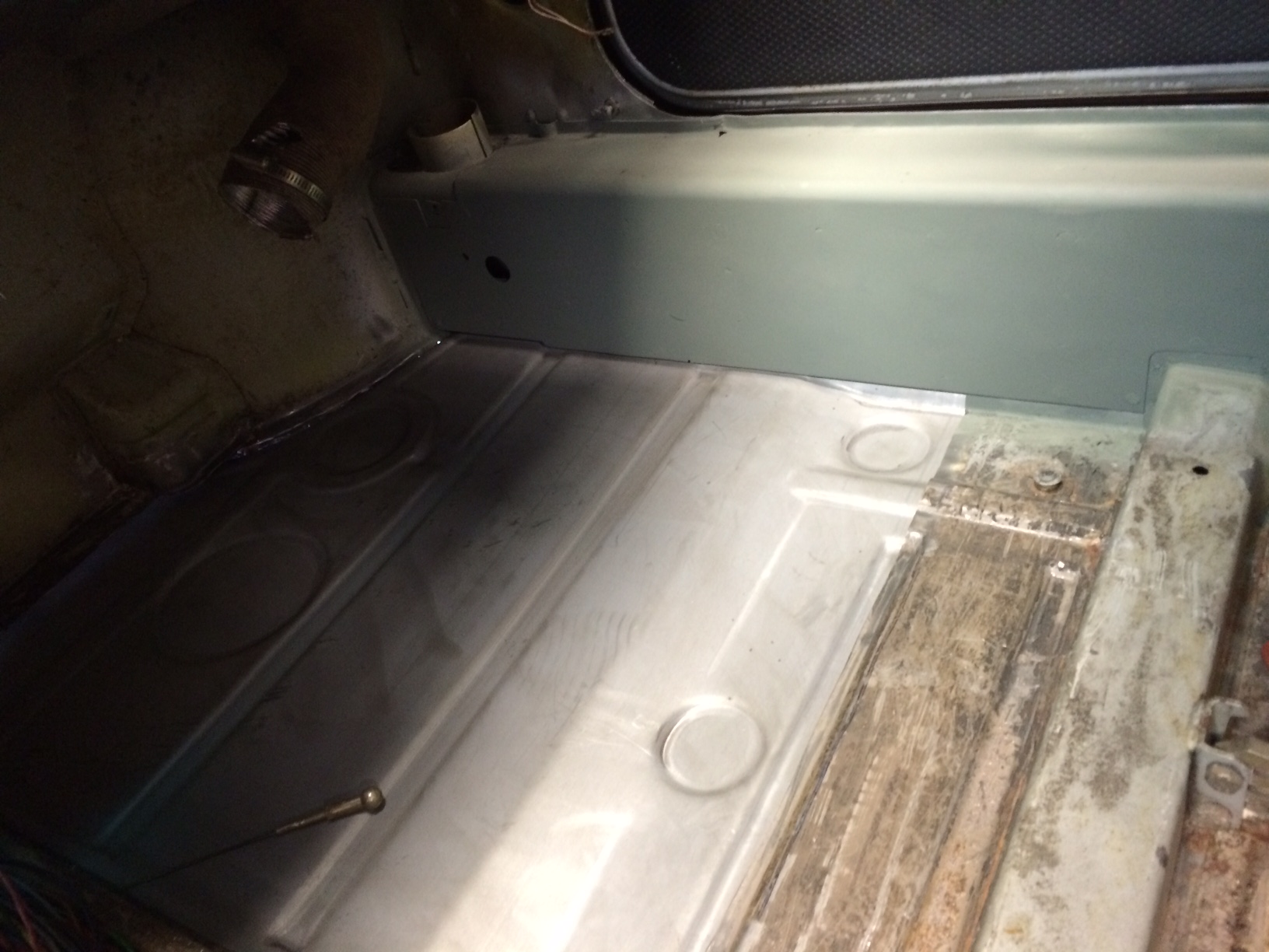

tygaboy   Floor fitted and ready for welding. :welder: Hop...   Dec 31 2015, 06:00 PM
tygaboy   I applied weld through primer between all the pane...   Dec 31 2015, 06:06 PM
