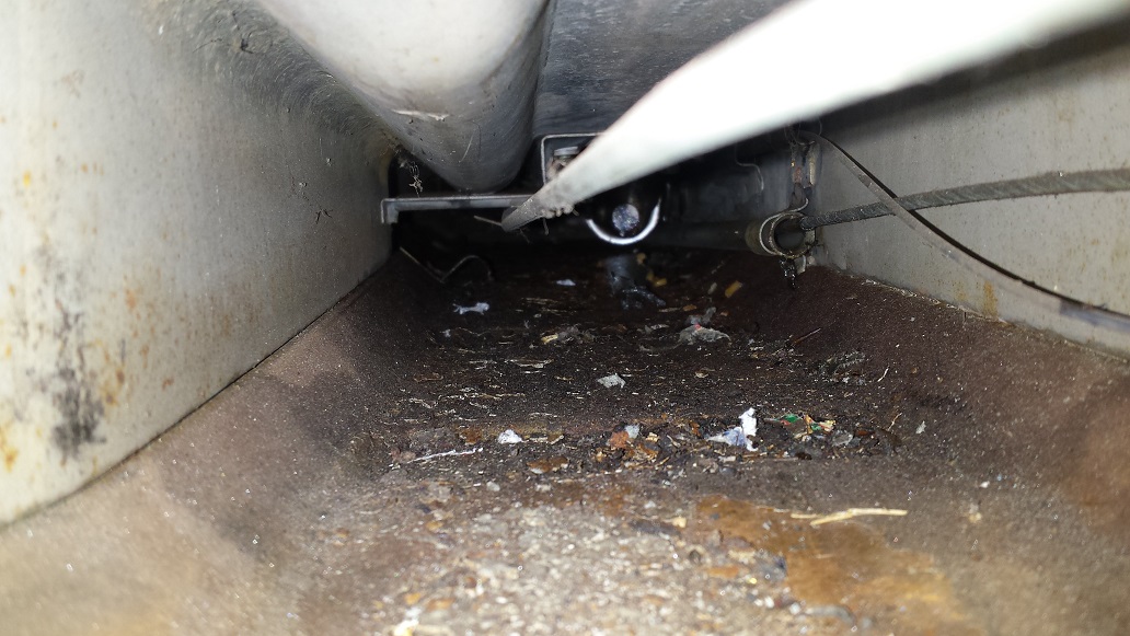

While it's open, here's a picture of the dirty tunnel. Guess I should clean it out before welding it up again...

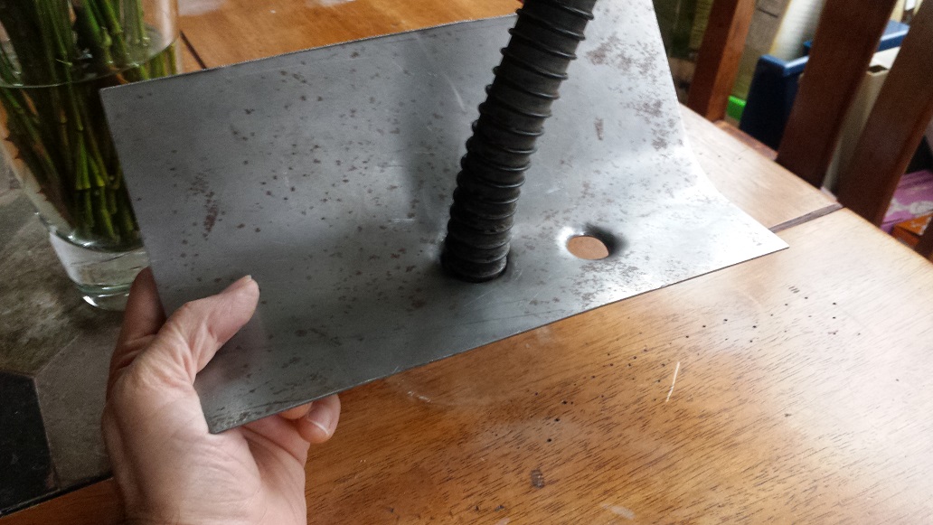

mbseto   Test fitting the heater tube. Going to need a li...   Aug 29 2016, 09:40 PM

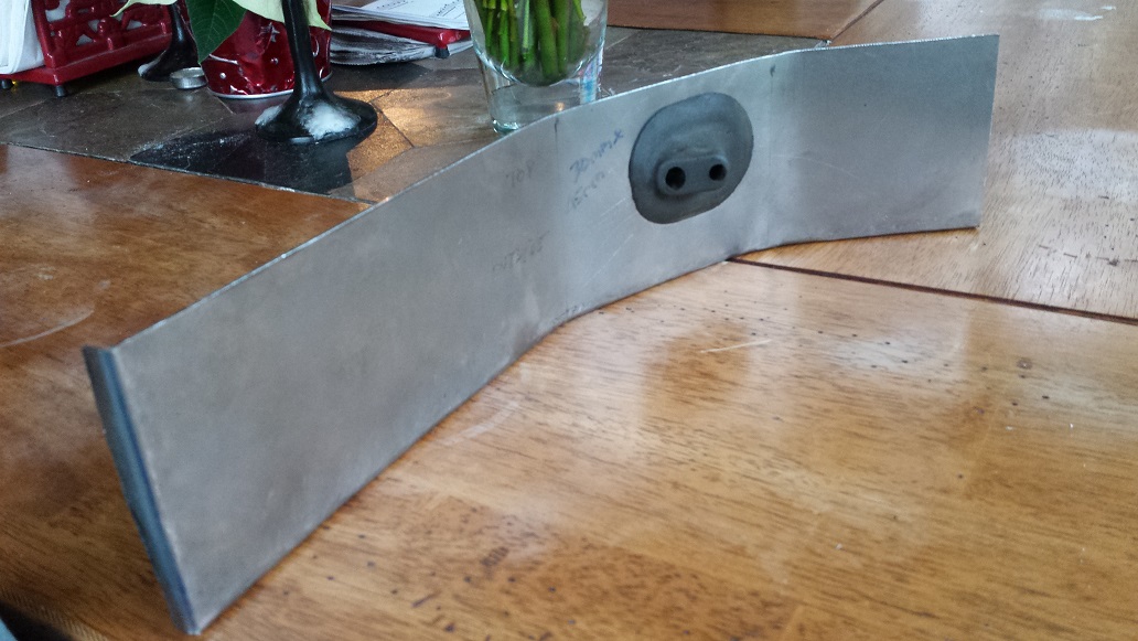

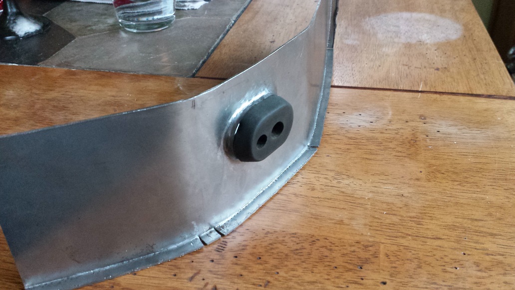

mbseto   Another thread I was reading was talking about how...   Oct 26 2017, 11:36 AM
