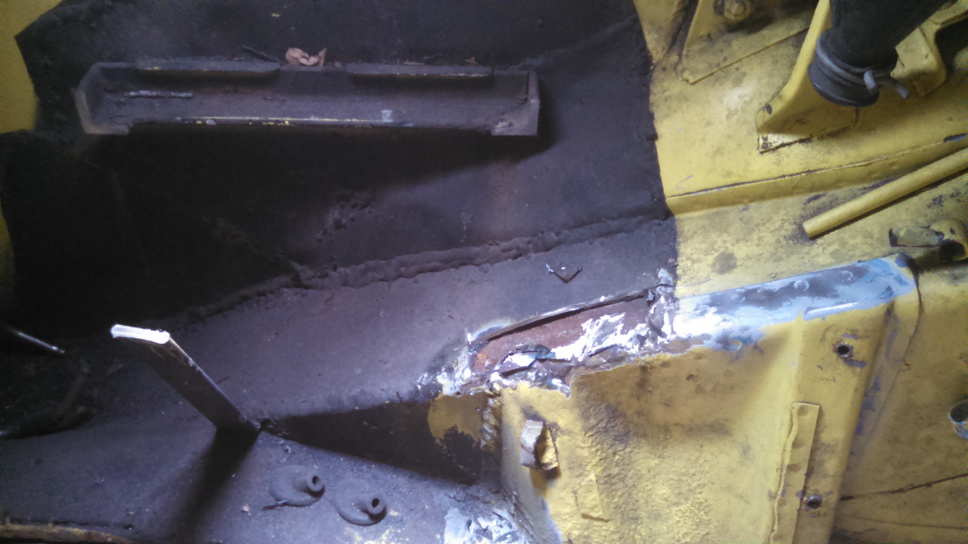

So I have leaped in with both feet. I started cutting. I had to cut out my "GT style" battery tray (fabricated from angle iron). I started to clear out the section of the shelf that would need to go and clear off the paint etc to see where are the welds are that I would need to drill out.

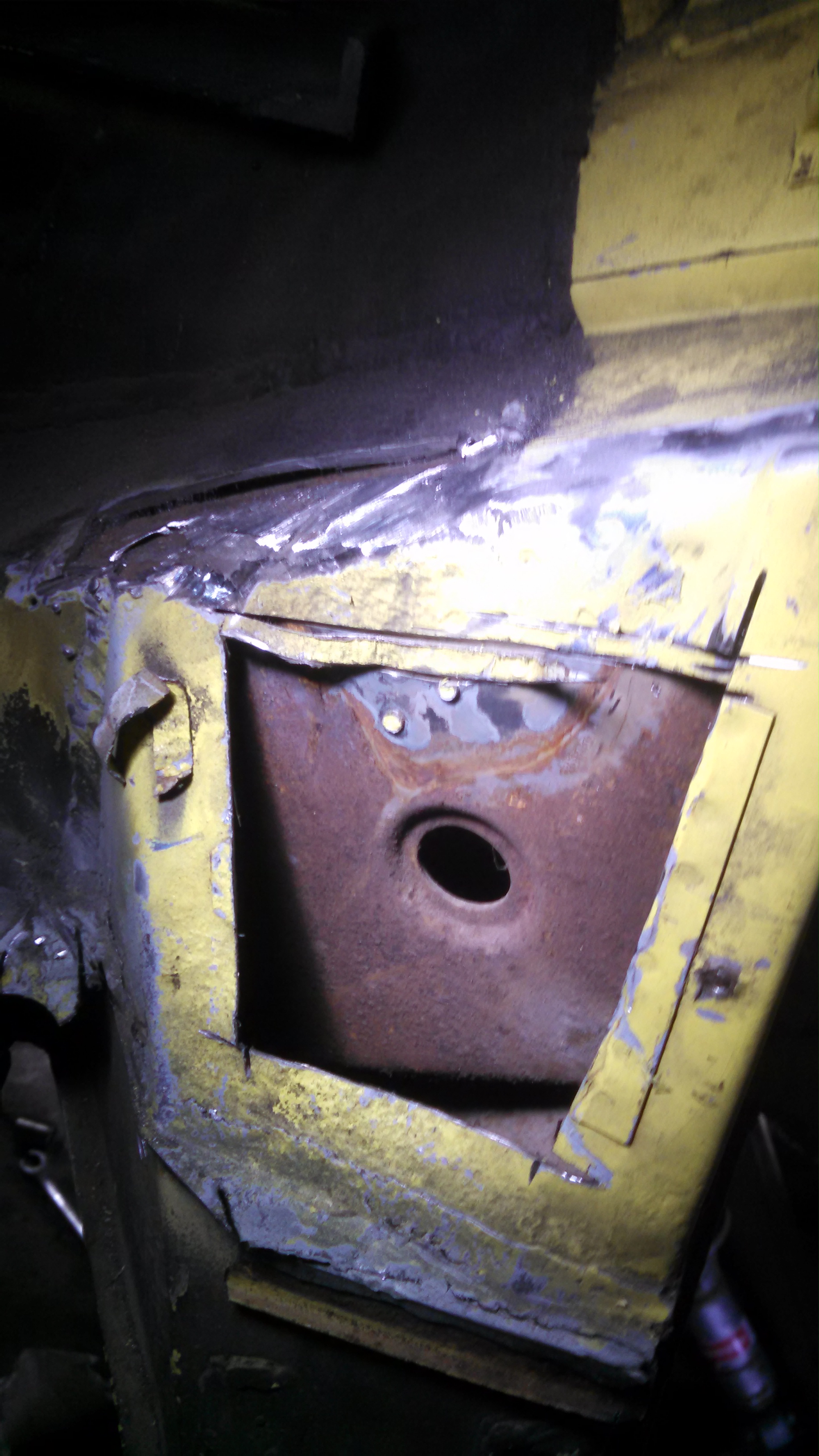

I accidentally trimmed too much and revealed the chassis under the suspension console at one point and decided I would see how bad things are before killing myself drilling out all the welds and finding that there is nothing behind it.
I cut a peek hole in the console and revealed rusty(loks to be mostly surface) but solid metal underneath.
I now need to get another couple of abrasive discs, a better face shield and the weld cutter to get in and really make some headway.
