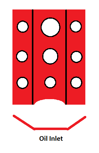

If you do install a baffle I would recommend a different design. A full baffle (all the way across) and a hinged plate are ideal but not when you can't maintain it (like in a welded tank). The second option is a full baffle with holes drilled into it like the picture below. The cutout in the bottom is so sludge wont accumulate. The bends are there to channel flow, again to eliminate sludge accumulation. You could eliminate the bends if you spaced the baffle off the bottom a bit or added more cutouts. You want minimal contact on the bottom to eliminate anything settling there.
