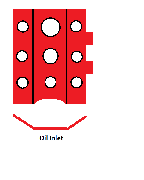

mb911   here is a rough template. I will test fit over the...   Dec 15 2015, 11:03 AM
jmill   Looking good. If you're going to mass produce...   Dec 15 2015, 04:38 PM
mb911   Looking good. If you're going to mass produc...   Dec 15 2015, 07:11 PM
mb911   Looking good. If you're going to mass produ...   Dec 16 2015, 06:22 AM
mb911   Looking good. If you're going to mass produ...   Dec 16 2015, 10:46 AM
mb911   Ok another question for all of you. The oil line ...   Dec 16 2015, 06:22 PM
mb911   Here is the first revision to the plug/template an...   Dec 17 2015, 10:42 AM
mb911   and a comparison. may still need to revise more bu...   Dec 17 2015, 11:51 AM
mb911   Ok another update. The revision fits in perfect.. ...   Dec 17 2015, 02:30 PM

jmill   You can add tabs. Cut two slots in the backside a...   Dec 28 2015, 02:22 PM
jmill   Ugly pic but you'll get the idea.   Dec 28 2015, 02:29 PM

mb911   So quick update this is the final transfer pattern...   Jan 13 2016, 07:18 PM
mb911   1st one for jmill and remote oil filter set up   Jan 17 2016, 06:06 PM
mb911   I used baffle specd by customer production units w...   Jan 17 2016, 06:09 PM
mb911   Tank ready for -12 weld on bungs   Jan 17 2016, 06:10 PM
