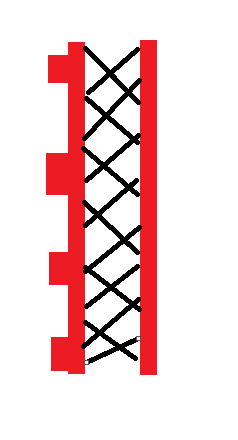

jmill   You can add tabs. Cut two slots in the backside a...   Dec 28 2015, 02:22 PM
jmill   Ugly pic but you'll get the idea.   Dec 28 2015, 02:29 PM
