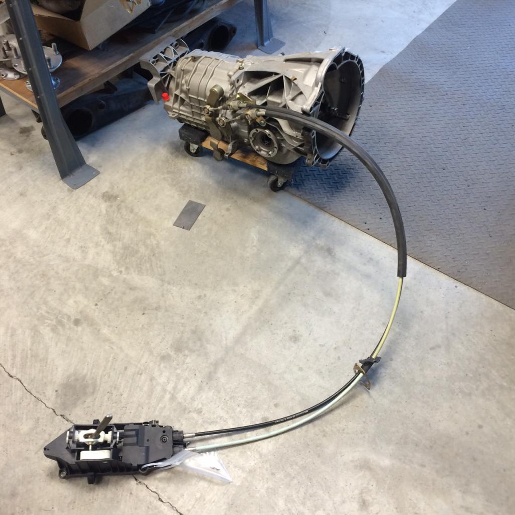

It is FREEZING here in foggy Petaluma, CA so during my holiday break, I'm not getting as much done as I'd hoped. Plus, some more Boxster drive line goodies showed up and I couldn't resist hooking them up and making engine/shifting noises!
And all I could think was "my shifter control can go around corners!".
Let's hope this is the only time these parts will be in this orientation!
And as you've all heard, this trans set up really does go "snick snick", with very little effort. And that's with the shifter just floating around on the floor. It's certainly going to be a little while but man, I can't wait to drive/shift this thing! (IMG:style_emoticons/default/driving.gif)
