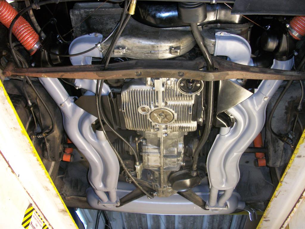

I finally got the heat exchangers on today. What a bloomin fiddle. I got 4 new copper washer seals and 2 rear box gaskets. The copper washers wouldn’t stay in the heads as gravity was not my friend (I’m sure they must have built them upside down at the factory!) I ended up putting a couple of small blobs of exhaust paste on them to hold them in the head recess.
The next issue was getting exchanger “hoops” around the studs. Something was out of line and they both fought me, but in the end after a struggle then went on. I’d previously cleaned up the threads and put a smear of copper grease on them. Then I could only get 3 out of the 4 copper nuts on. The 4th one on both heads (would be the hardest one to get to) wouldn’t go on?
After a bit of head scratching I needed to lower the exchangers until the other 3 nuts were only just on by a couple of threads to get the 4th nut on, then pull them all up together. It was the bend in the pipe that was stopping the last nuts going on (due to the integral moulded washers) when the stud is poking fully down and the exchanger is fully up.
Next I shone a flash light up around the copper washer gaskets to check the heat exchangers had located properly in the small counterbore (where the copper washer sits). I then fitted the rear box with new gaskets, stainless nuts & bolts and left them finger tight to avoid pull on the exchangers. Once everything was in place I tightened the exchangers to head and finally the 6 rear box bolts.
Again it was one of those jobs that took 3 times longer than anticipated. Looks good though with its nice shiny paint finish!

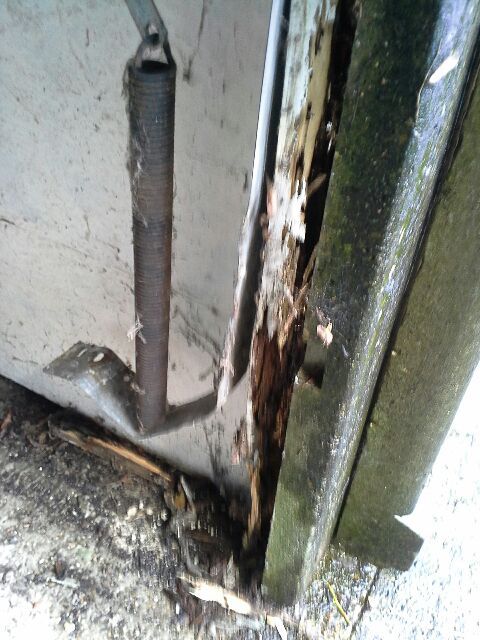

The bottom 3 ft of door frame had completely rotted away and the door spring mechanism just coiled and wrapped itself up in free air.
(IMG:http://www.914world.com/bbs2/uploads_offsite/i265.photobucket.com-18255-1451512149.1.jpg)
(apologies for photo quality, it was off my work phone)
What complete bunch of morons would fit a new door lock, return to their office, hand over the keys and say “there you go, ready to rent out”
I’ll have to wait until they open tomorrow now to see what they say. The door barely opens, wont stay open and even if you lock the nice new lock, the rods that latch the door shut have nothing to latch against so you can simply open the door with it “locked”

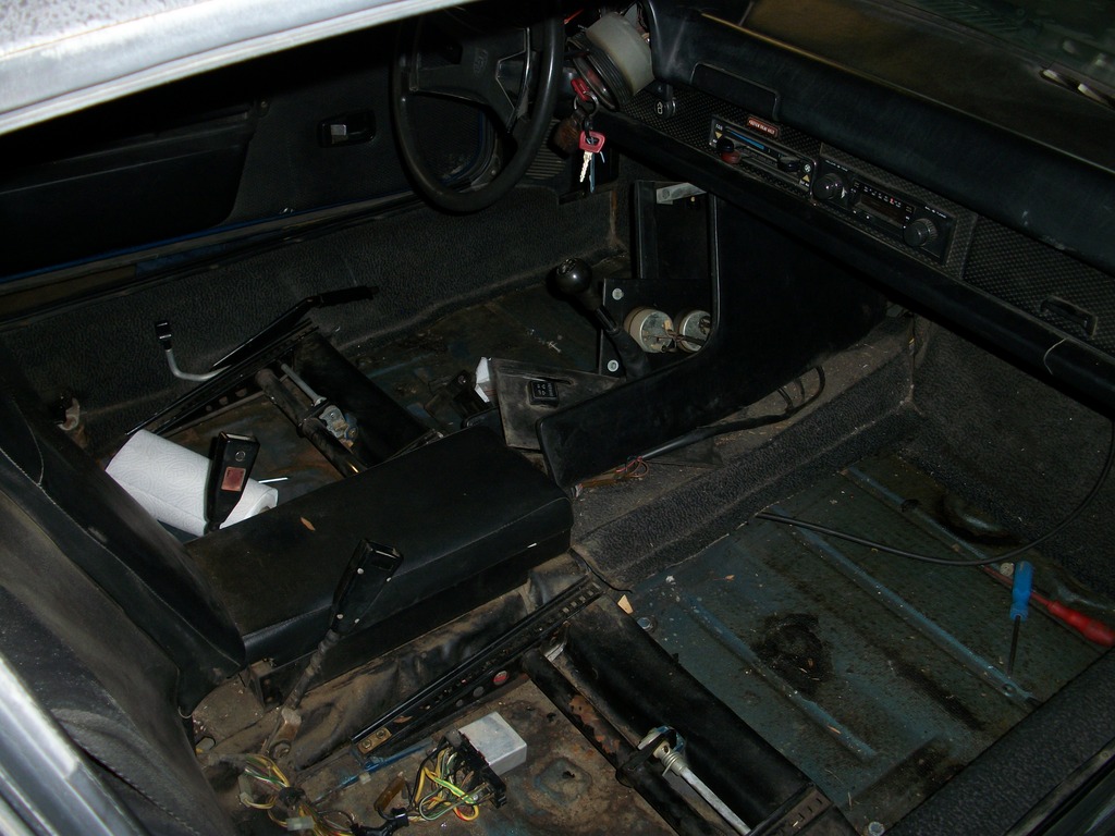

It then occurred to me that I’d not taken any pictures of the engine bay to show how it arrived. I wish I’d done so because people I’ve spoken to so far can’t quite grasp how much sand and dirt was in there. So here’s a picture of the throttle body as it came off.
(IMG:http://www.914world.com/bbs2/uploads_offsite/i265.photobucket.com-18255-1451512149.2.jpg)
This was slightly shielded by the air filter and carbon filter, so hopefully you’ll get the idea.
I spent two hours tonight carefully taking it apart and starting the big clean up. Hopefully tomorrow I’ll have a better day.

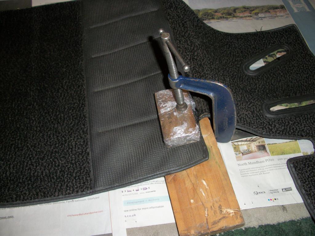

After cleaning last night and 10 hours at the weekend my hands are as rough as sandpaper so I thought I’d give them a rest and go back to the floor mats. After sewing the damaged edge trims back on the other night and melt/welding the plastic bits around the pedals I needed to sort out the heel mat.
The pile on the carpets came up like new. I was really surprised and pleased as they had 40 years of muck, oil, road tar, chewing gum and desert sand on them. All the colour is back as is the grey fleck that was'nt at all visible before!

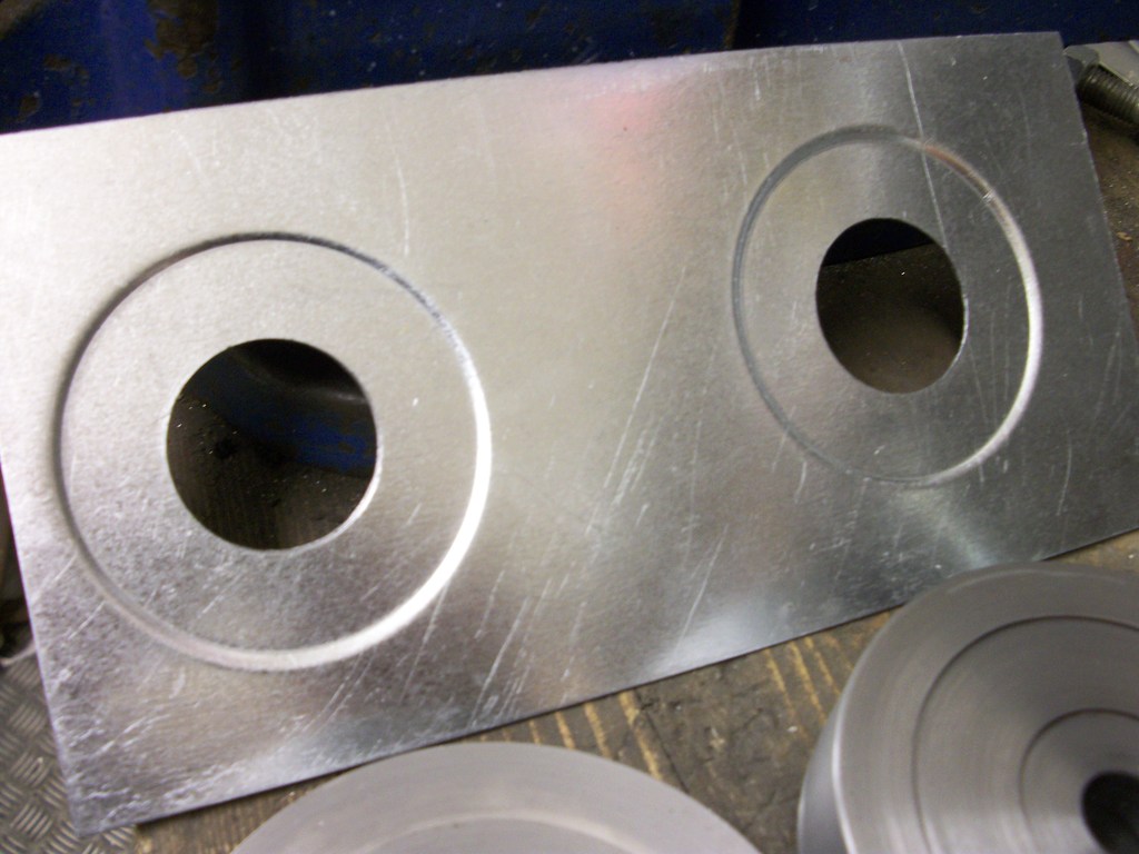

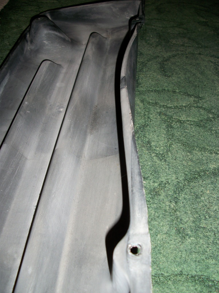

The PU adhesive was “injected” under the lifted heel mat and used to glue it back down. The area at the base of the accelerator pedal was all split and a section missing. It had a hole worn completely through the mat. The heel pad is a particular texture size with heat mounded ridges. I could simple sew in a new pad but it wouldn’t be the same, so I thought I’d try a low cost repair first.
I used the PU adhesive to mould the tiny missing triangle back in the mat around the pedals and then I masked up the hole in the mat from the underside.
Rested on a flat surface (bit of 4” x ¾” timber) I filled in the hole with some plasterers scrim tape and more PU adhesive. A second flat surface on top (wrapped in cling film for easy release) was clamped on.
When the PU adhesive is dry tomorrow morning I should have a strong flexible hard-wearing hole repair under the original broken vinyl heel mat. This should give it some support for repairing the damaged surface vinyl tomorrow.

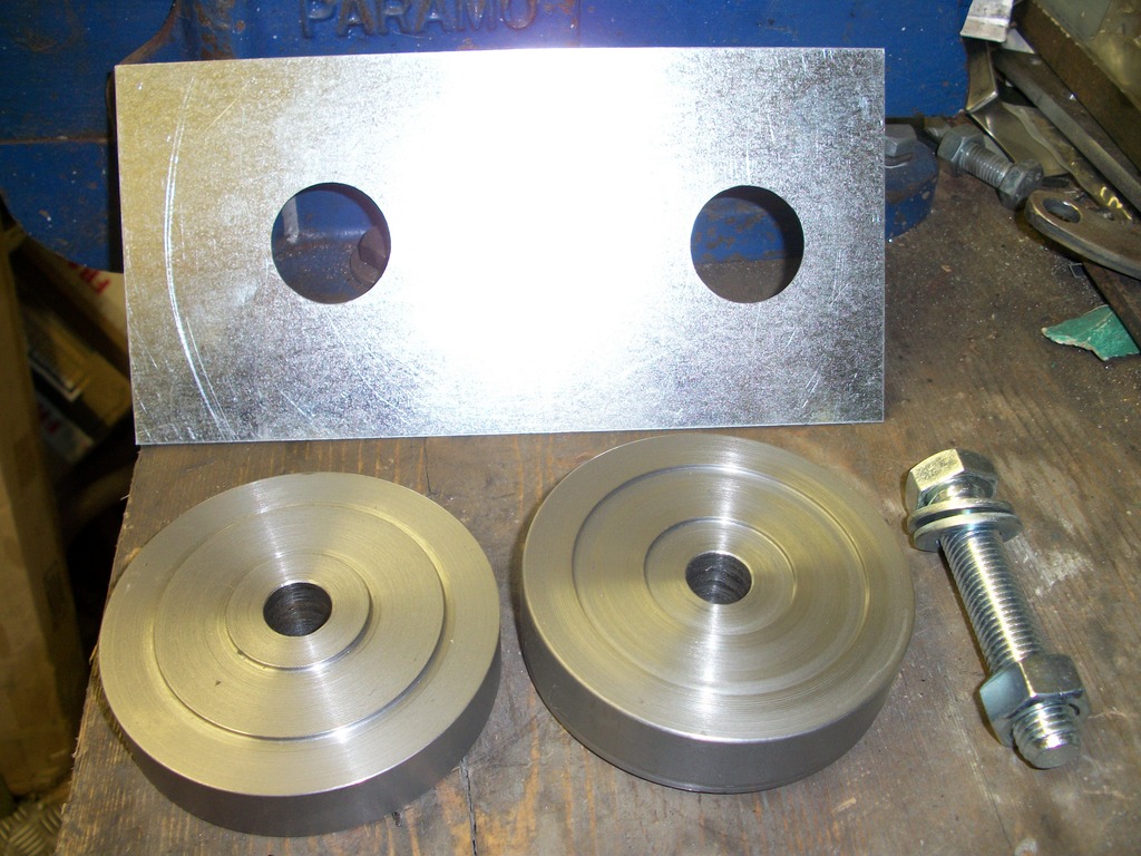

(IMG:http://www.914world.com/bbs2/uploads_offsite/i265.photobucket.com-18255-1451512149.3.jpg)

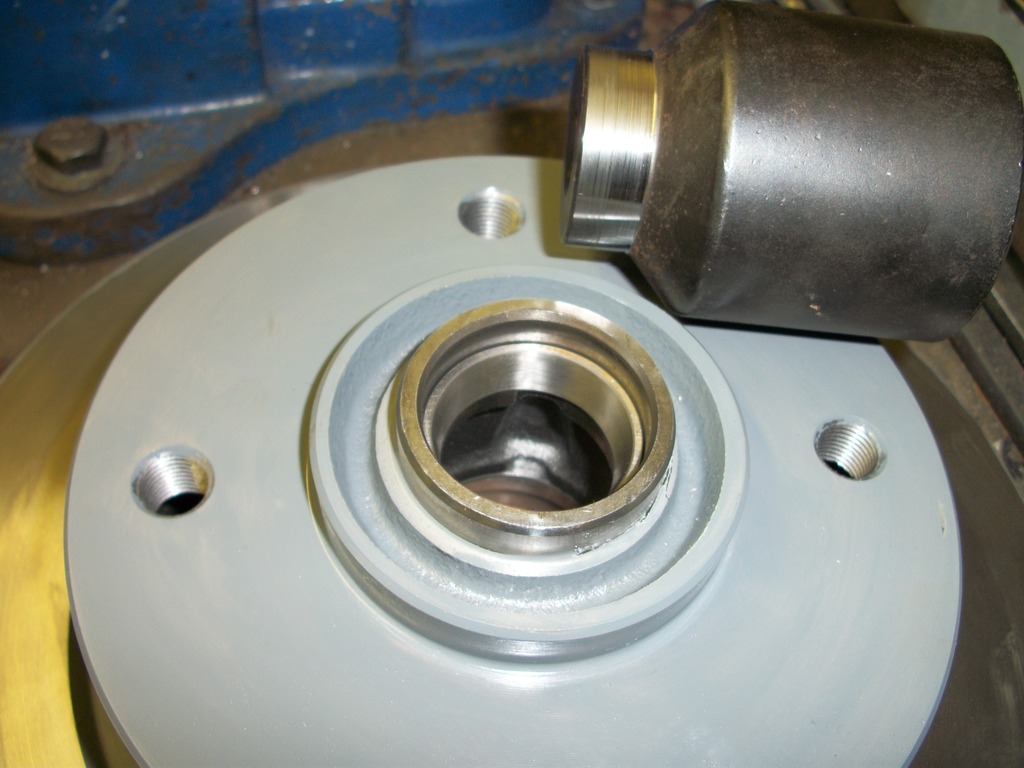

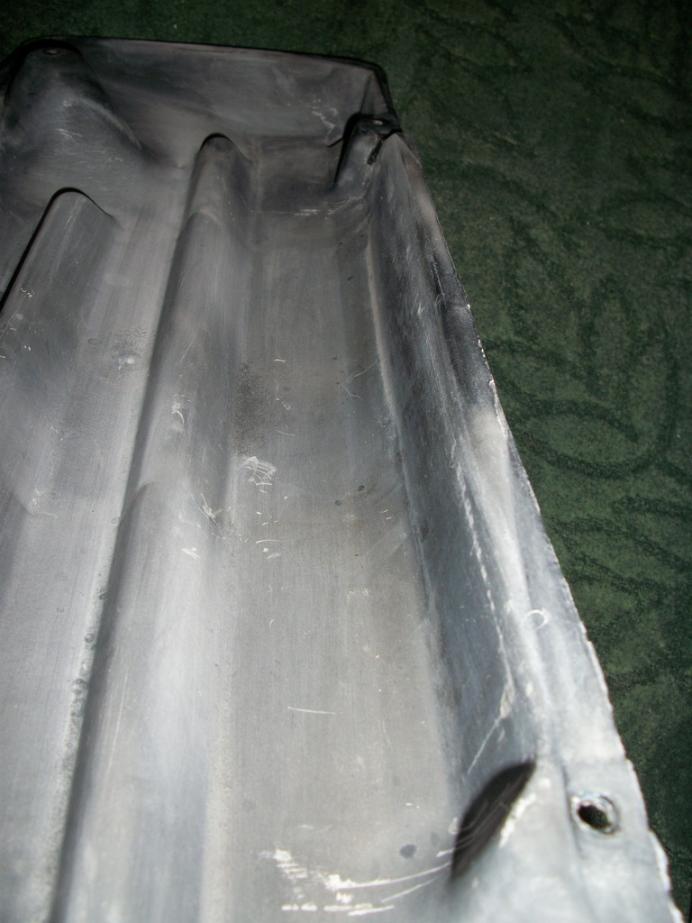

This morning I released the clamp of the heel mat and had a good luck at the hole repair in the mat. All looked good. I put a final layer of PU adhesive on the rear of the mat just to tidy all the frayed ends and left for work while it dried.
(IMG:http://www.914world.com/bbs2/uploads_offsite/i265.photobucket.com-18255-1451512149.4.jpg)
During lunch I visited the car in storage and picked up a few bits and bobs I had taken off and put in the boot, plus arranged times to work on it at the weekend.

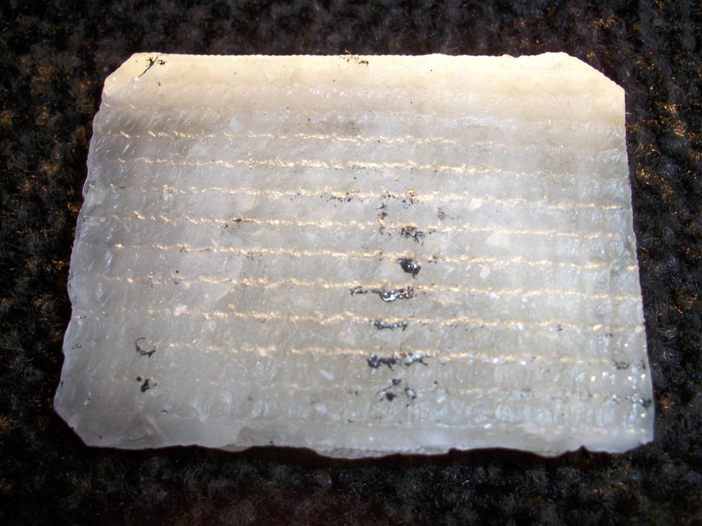

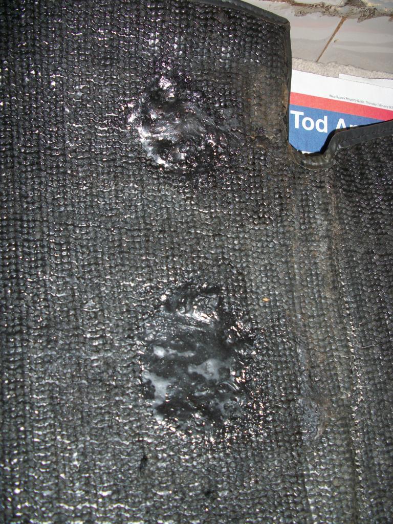

This evening when I got home I started on the heel mat part of the hole repair that will be seen. The mat has a very specific texture/moulding finish to it which I needed to replicate if the hole repair was going to be invisible. I decided to take a cast of the heel mat in a position where it was in good condition.
I made a small contained area about 2” x 3” (just bigger than the hole repair) using masking tape and then coated the heel mat in the middle with a little liquid soap using a modellers paint brush working it into the pattern. Next I cut some more small squares of scrim tape and lit a large candle. Carefully dripping candle wax into the contained area and adding scrim tape in layers I made a cast of the heel mat textured surface.
(IMG:http://www.914world.com/bbs2/uploads_offsite/i265.photobucket.com-18255-1451512149.5.jpg)
Once cool it easily lifted out. I put it in the fridge to set solid while I had dinner.
Next I mixed up some light grey and black PU adhesive to as close a match as I could to the original dark grey. More liquid soap was brushed into the wax cast and the PU carefully applied to the top part of the hole repair.
Pressing in the wax casting as I went along creating the exact pattern in to my repair area. I was careful to line up the pattern for a matching repair.
(IMG:http://www.914world.com/bbs2/uploads_offsite/i265.photobucket.com-18255-1451512150.6.jpg)
The PU adhesive dries to a tough flexible rubber so should be long lasting. I intend to get some aftermarket tailored overmats for the car and the originals will be protected. I just feel better that whenever the new overmats will be lifted out for cleaning I’m not met with a gaping hole

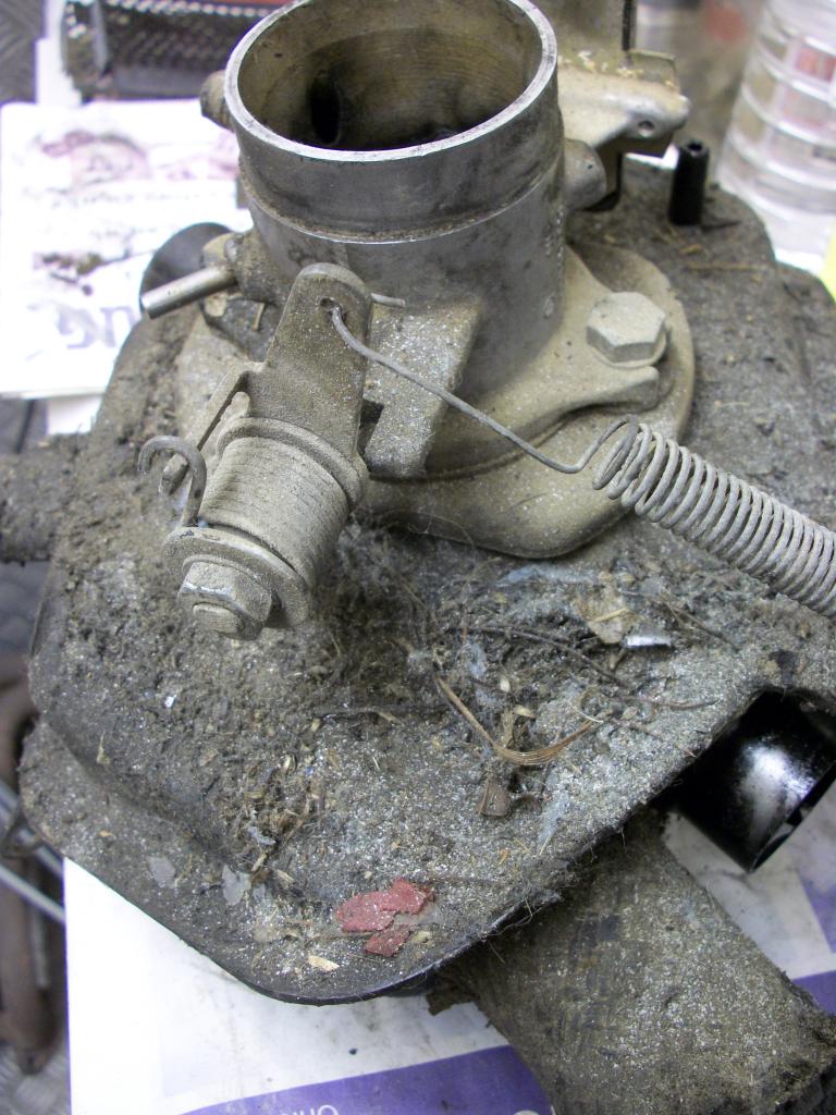

This evening I started to strip down the FI throttle body. There is quite a bit of wear in the butterfly spindle so I need to see if just a new shaft will sort it or whether I need a new shaft and sleeve the body. Looks like it’s 40+ years of fine desert sand again getting into the gap between body and shaft and grinding it away. All made worse by grease or oil put on by the PO helping stick the sand in place to make what can only be described as grinding paste.

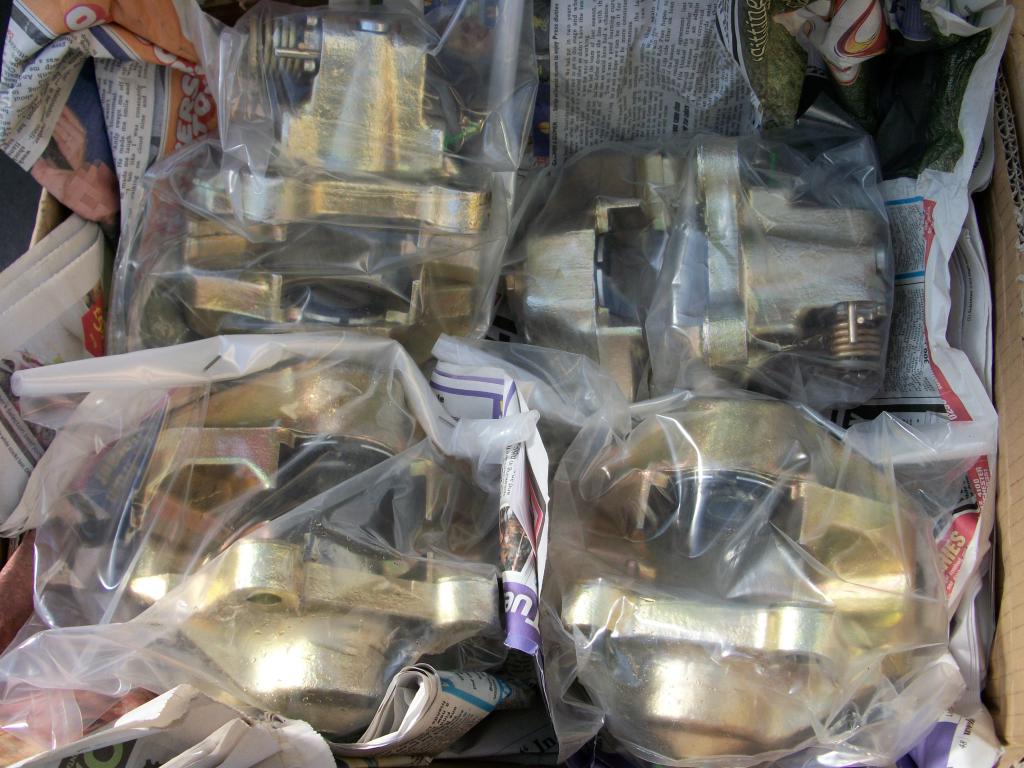

Anyway, after picking up the parts this morning I got home and started moving a few cars around and took another one out to Machine Mart and bought some car skates, got back home and spent an hour putting them together before lunch so that I could spin yet another car around.
A van then pulled up and delivered these…..
(IMG:http://www.914world.com/bbs2/uploads_offsite/i265.photobucket.com-18255-1451512150.9.jpg)

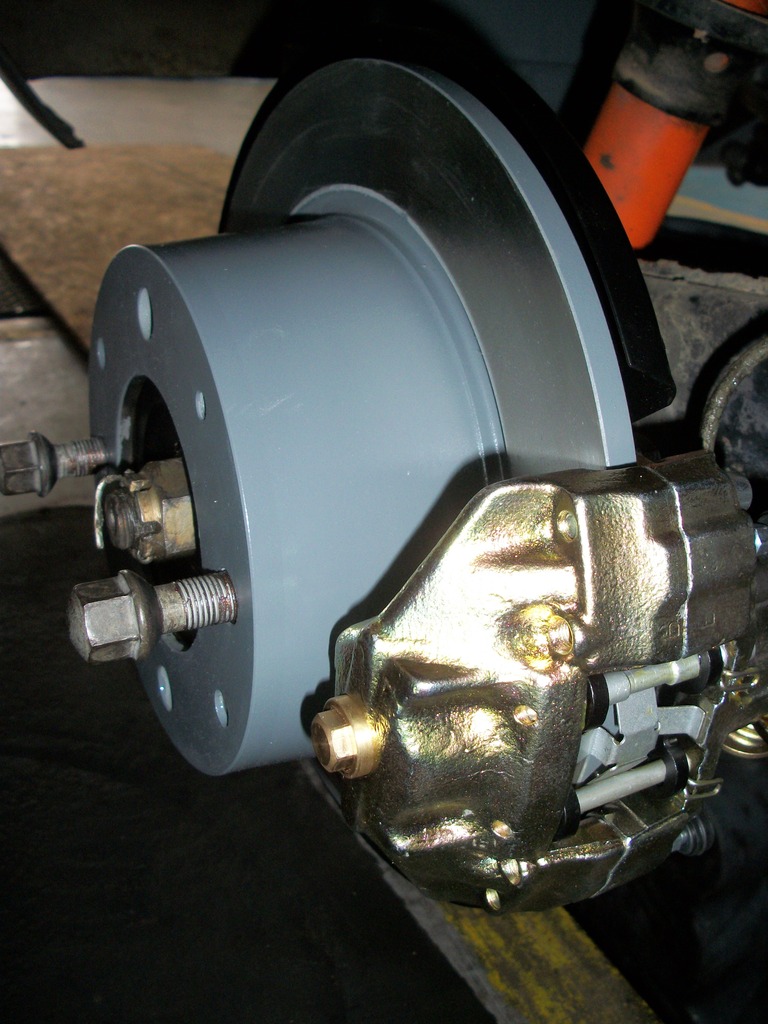

Ooooooo they do look nice, absolutely fantastic refurbishment can’t wait to get them back on the car. Problem is that Berlyn Services STILL haven’t got my new discs and wheel bearings yet. I did call them last week, but was told they are on transit from Germany. I can only presume they are being delivered by tortoises not hares.

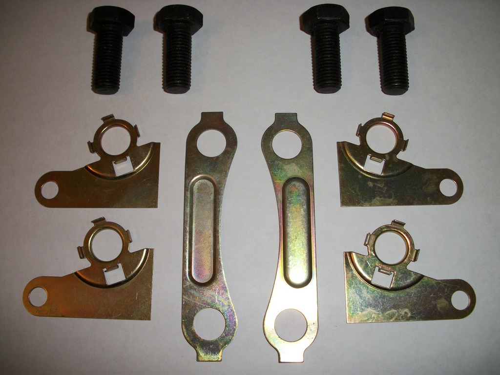

I found a set of NOS front calliper piston retaining plates (the ones that sit behind the pads) calliper bolts and new lock tabs on US ebay in a kit for £6 a few evenings back so hopefully they’ll arrive next week. New pads and refurbished pins waiting, new handbrake cables fitted, it’s just the discs now that’s holding me up.

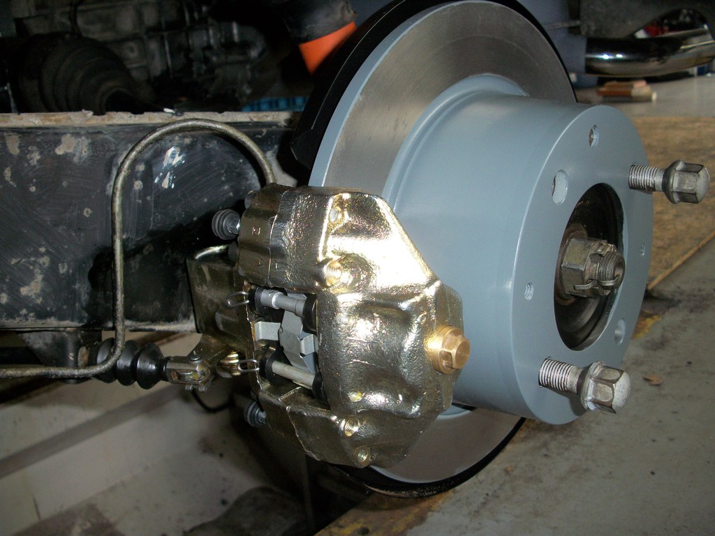

Today I have mostly been underneath the car.
With the callipers done, pads and pins done, I thought they look so good that I simply couldn’t leave the disc backing stone covers looking their age. So the first job this morning was to take off all 4 original discs and remove the backing plates (and tie bar from the rears). I’ll drop them off tomorrow with the bead blasters and get them cleaned up and powder coated ready for when my new discs arrive.
I had to put the old discs back on again afterwards so that the car is still mobile.

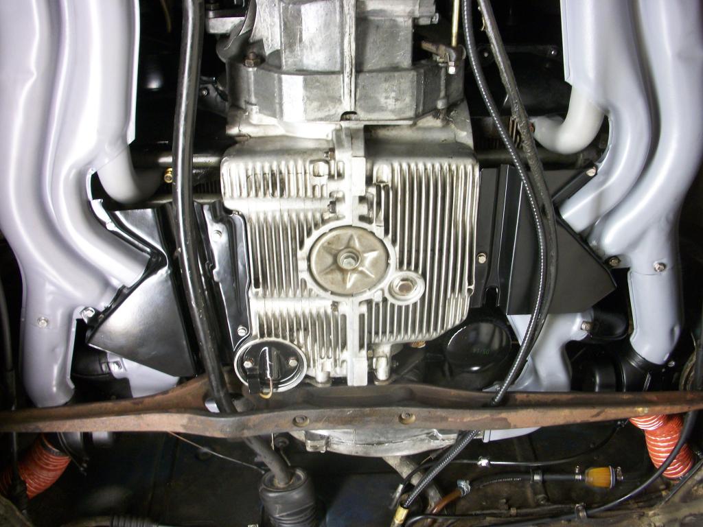

Next I finished off putting on the tinware under the engine and replacing all the slot head screws with stainless steel.
I then took off the old damaged heater hoses, cleaned up around where they attach to the car and cut my nice new hose to length. These were then fitted with new stainless steel jubilee clips.
(IMG:http://www.914world.com/bbs2/uploads_offsite/i265.photobucket.com-18255-1451512150.10.jpg)
Next I sorted out the heater flap box cables and fitted them to the operating levers. After a bit of a fiddle, I managed to adjust them correctly so that the lever in the car opens and closes smoothly and fully.
(IMG:http://www.914world.com/bbs2/uploads_offsite/i265.photobucket.com-18255-1451512151.11.jpg)

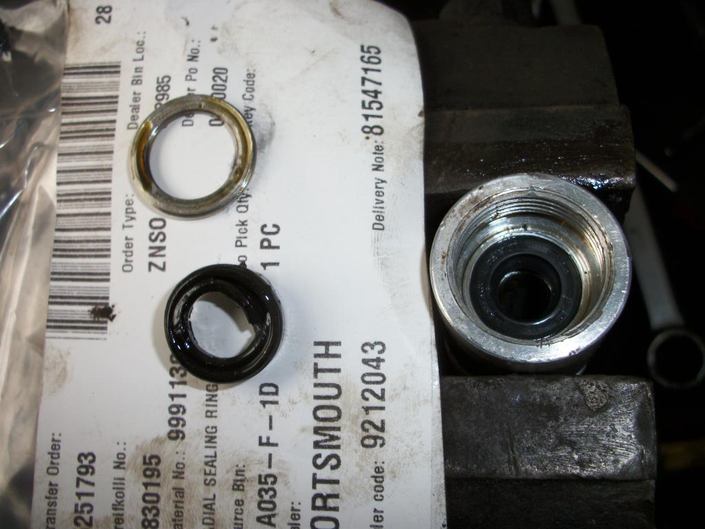

While the oil was out I decided to change the angle drive seals. Since cleaning the gearbox off the other weekend I could now see that it was the source of a leak as expected. I got the “O” seal, aluminium washer and lip seal from Porsche all for a tenner so set about changing them.
(IMG:http://www.914world.com/bbs2/uploads_offsite/i265.photobucket.com-18255-1451512151.12.jpg)
(don’t panic, the vice is lightly holding the drive while I hooked the old lip seal out, not squashing it)
Once cleaned up I rebuilt the angle drive a fitted it back into the car. The retaining bolt was inserted by hand so that I could feel it locate correctly before a spanner was used. Nipped up and as said before “the wobble is standard” but at least it’s not leaking now and wobbles far less. All in all it looks a lot cleaner under there now (compared to even the picture on page 6 of this thread when I had already cleaned for several weekends)

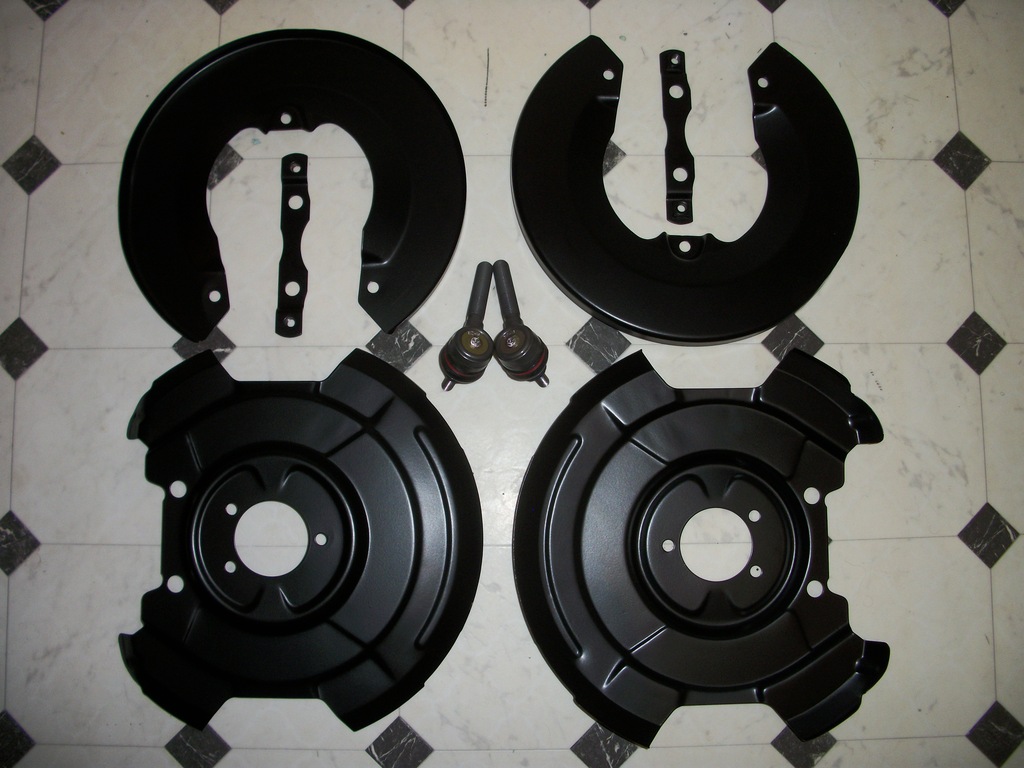

This morning before work I did a little tin bashing in my shed on the removed brake backing plates. They were a little out of shape and the edges were battered flat in places. I had a rummage around in one of my sheds and found some old discs off one of my other cars that were a perfect diameter (just a little larger than the 914 ones). I clamped one in the vice and used it as a former to get the backing plates back into shape using a range of panel beating hammers (so as not to get half crowns in them).
I then went to my friends unit and moved the car out into the compound so that he could start work at 7am.
During lunch I went over to the powder coaters and dropped off the backing plates for blasting.

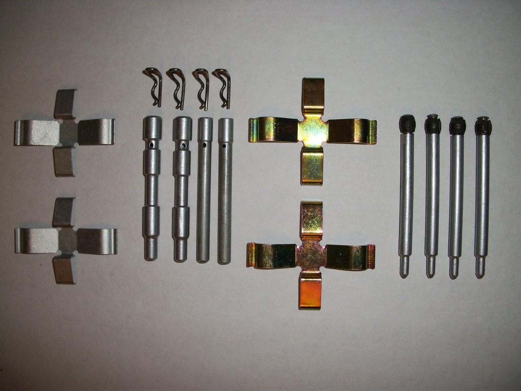

Tonight I started on fitting out the callipers with my nice new bits.
Here’s the old refurbished Pins and the new clips I sourced earlier.

Following the superb refurbishment of my Calipers I still needed to find new calliper piston locking plates for the front (the ones that stop the pistons turning and sit behind the pads) and the long locking tab washers for the calliper mounting bolts.
Both parts no longer available I eventually found them on US ebay using a Porsche Part number search.
As said before they were NOS and contained all seals, clips and rubber gaiters to rebuild the front callipers. Having just had mine done I only needed the missing parts below.
(IMG:http://www.914world.com/bbs2/uploads_offsite/i265.photobucket.com-18255-1451512151.14.jpg)
The rest of the parts (calliper piston seals, dust gaiters & clips) I’ll keep for the future. Not a bad kit for just over £7 a side, even comes with new High Tensile mounting bolts!
Tonight I assembled them into the front callipers using a light smear of Mintex Cera Tec special brake anti corrosion grease.

Today I picked up some new spring washers for the rear calliper bolts and spent this evening painting the new track rod ends.
They arrive in bare metal and would corrode in time so I mixed up some black & silver in an old spray can lid to match the cast steel colour and gave them a coat of paint. You’d never know they were painted to look at them but hopefully it’ll slow down the rusting process.

During lunch I picked up the disc backing plates. Tonight is food shop night so after getting home later than normal and filing up the cupboards I went off to the shed.
As soon as stuff comes back from the powder coaters I tap out any threaded holes. With all the will in the world masking stuff up, the powder coat process is electrostatic so it creeps into the smallest gap.
Threads cleaned out and a little copper grease applied, they’re good to go for assembly over the weekend. Considering what the backing plates looked like beforehand(rusty dented and bent out of shape) they are flawless and BETTER than new now.

It was also another Desert Sand nightmare day. Getting the old speedo cable out meant getting under the centre console. I took the seats out for more space and after finding where the console securing screws were I lifted out the two insert panels and found the whole inside of the console had about ¼” of fine sand inside it.
Another ½ hour hovering and I could lift the carpet to reveal the cable and the bent over securing tabs.
(IMG:http://www.914world.com/bbs2/uploads_offsite/i265.photobucket.com-18255-1451512151.16.jpg)
Seats out there was more sand in all the creases and gaps around the centre tunnel. The ridges in the vinyl were ½” deep in sand! More hovering up.
Anyways, after getting the cable out I could see the age related damage more clearly.
(IMG:http://www.914world.com/bbs2/uploads_offsite/i265.photobucket.com-18255-1451512152.17.jpg)
It really did need changing.
What a pig it is trying to hook the cable end out of the tunnel void and into the car on your own. I ended up bending a coat hanger in a U shape to fish it out. I also noted the route it takes over the steering UJ and found metal bend over tabs to hold it clear of the steering. Not obvious first of all but there for a good reason.

Next I cleaned up the spring rods which were caked in sand and surface rust. Rubbed them down with wet & dry and gave them a zinc prime.
After washing out the water trough earlier it was now dry so I got my heat gun and started to straighten out the bow and distortion in it.
(IMG:http://www.914world.com/bbs2/uploads_offsite/i265.photobucket.com-18255-1451512152.18.jpg)
And straightened out.
(IMG:http://www.914world.com/bbs2/uploads_offsite/i265.photobucket.com-18255-1451512152.19.jpg)
Finally I melt/welded the two cracks up on it.
It’s very sun bleached, so tomorrow morning I plan on trying a little rubbing compound on it to see if it takes off the milky surface back to black. Last resort is to paint it with some satin black bumper paint, but I’d prefer not too.

So again to recover what was left of the morning I decided to go up to the unit and get the rear discs fitted.
I managed to get both sides on, fit the callipers & pads and connect and adjust the handbrake.
The pad clearance adjusting screws vexed me for a short while, then the penny dropped. The outer adjusters are LH thread. I’d adjusted the inners to get a pad clearance of 0.2mm easily as they are RH thread. I’d gone to do the outers and they just turned and turned with nothing happening (clockwise) so initially I was stumped
Anyways I managed to get the rear all assembled and adjusted, even if I didn’t get the fronts done. I’ve ordered a set of bearings for Monday and I’ve emailed Berlyn Services some pictures so will have to see what resolution they come up with on Monday too.

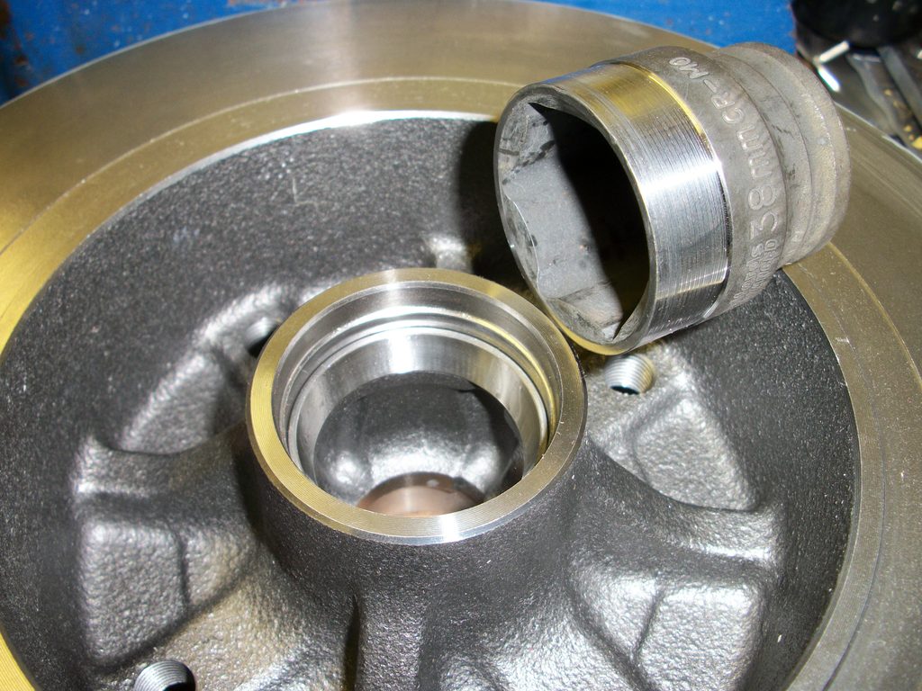

So tonight I finally got to fit them to my new front discs.
Because the old discs and bearings are still on my car which is a few miles away from home I couldn’t use the old outer races to drift in the new bearings as I would have normally done. Not wanting to do this on Saturday (as it would waste weekend valuable assembly time) I decided to see what I had to hand to make new bearing drifts. The inner race sits quite deep into the back of the disc so using an old outer race here to drift it in could end up with it getting stuck.
I had a rummage in my metal bar off-cut storage and the nearest bar I had would need a good 20mm turning down off the diameter which to be fair is a waste of the bar. I then looked in my big socket drawer and found two that were just about 1mm too big. I stuck them in my lathe and took a skim off them to get a perfect size and used them to nicely drift the new bearings home.
Inner drift
(IMG:http://www.914world.com/bbs2/uploads_offsite/i265.photobucket.com-18255-1451512153.23.jpg)
Outer drift
(IMG:http://www.914world.com/bbs2/uploads_offsite/i265.photobucket.com-18255-1451512153.24.jpg)

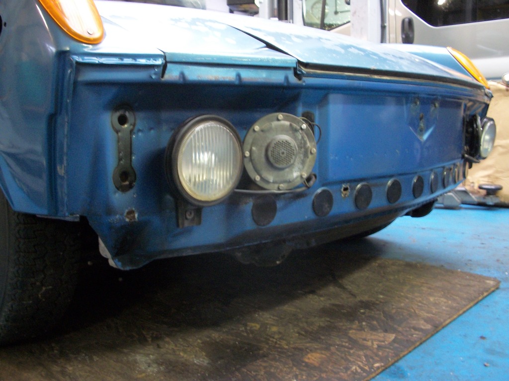

Day 86
Today I finished off turning my proto-type press tool (that I didn't want to mention until I knew it worked) and picked up a nice M16 bolt for the centre this lunchtime. No news on the trim part from Porsche so hopefully Monday it’ll be in?
I have been thinking on a good way of blanking the front wing marker lights. To do this well would require swageing a recess in the wing and welding in a disc of steel to blank it off. The idea is to dress off the weld and hopefully little or no filler will be required.
Last weekend I removed a light and took a set of measurements. The main issue is not only the large hole but the smaller fixing holes around it. To do this right I need to include the small fixing holes behind the new covering disc. The panel looked to be completely flat in the local area of the light, but tomorrow I will take along my new press tool and just check if there is any contour in the wing.
After work & Tescos tonight I got a piece of 1mm scrap steel and cut two test holes in it, the same size as those in the front wings. Next I located the press tool and simply tightened the nut and bolt to press a trial recess.

The plan tomorrow is to get the front discs, callipers, pads etc and fluid into the car, afterwards I can tinker with checking the tool and wing contours before I jump in and press them.

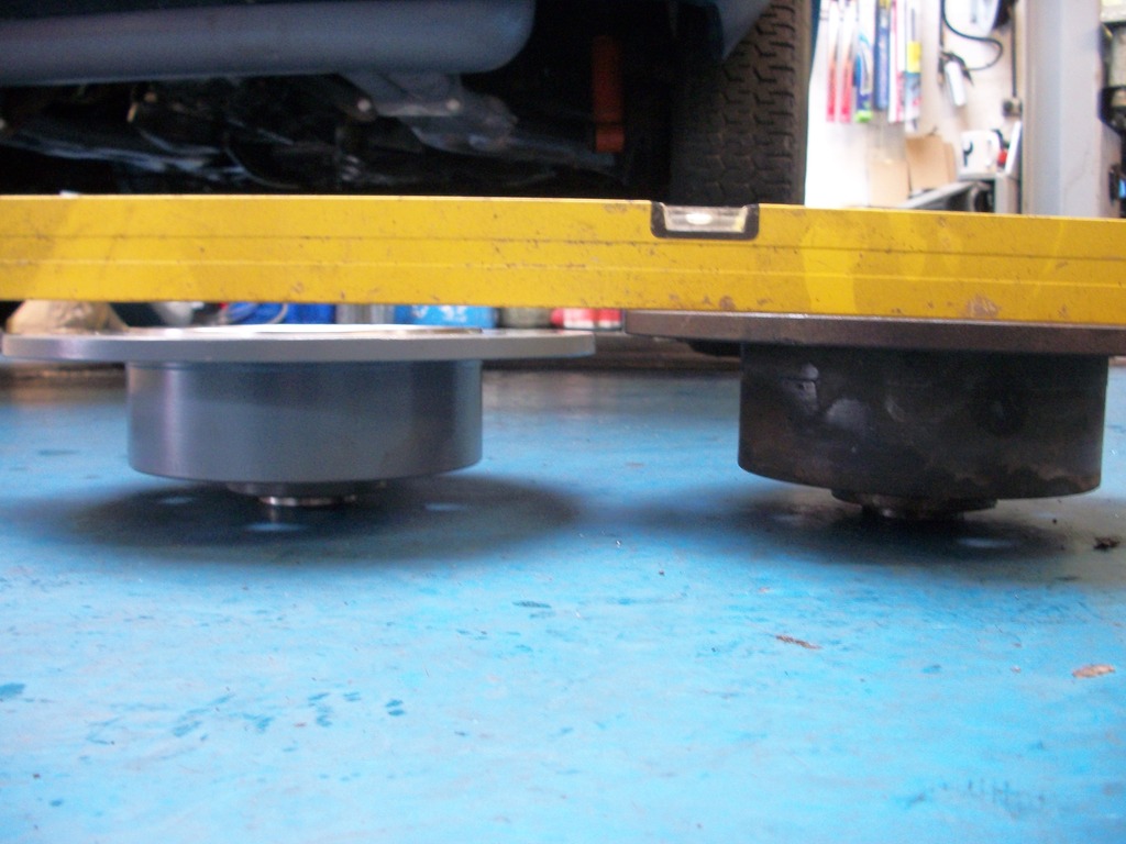

Question: When is a 914 front brake disc not a 914 front brake disc?
Answer: When you buy it from Porsche Specialists Berlyn Services and wait 6 weeks for it to turn up
(IMG:http://www.914world.com/bbs2/uploads_offsite/i265.photobucket.com-18255-1451512154.27.jpg)
What on earth have Berlyn Services sent me?
It certainly IS NOT 914, its VW Beetle!

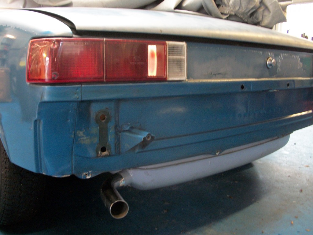

Today I needed to move forward regardless of the disc issue. The car is booked in the paintshop on the 20th of next month so today I started to strip stuff off ready for painting.
First I removed the front and rear bumpers. Both have a tiny bit of surface rust which isn’t an issue. They have dents and scrapes which is more of a problem. A bit of gentle tin bashing is required. It was nice to take them off and flip them over and find no rust at all, plus all the nuts bolts and washers were still shiny gold zinc plate.
Next the rear and front valances were taken off.
The rear is reasonably dent & rust free, the front however is pretty sorry for itself.
(IMG:http://www.914world.com/bbs2/uploads_offsite/i265.photobucket.com-18255-1451512154.28.jpg)
And the other side
(IMG:http://www.914world.com/bbs2/uploads_offsite/i265.photobucket.com-18255-1451512154.29.jpg)

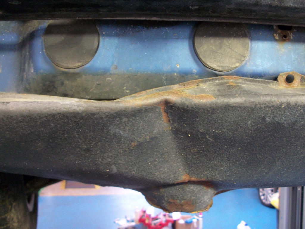

Both pressings around the suspension mounts are dented, torn and generally in a mess. I’ll have to do some serious tin bashing here to revive them.
Again I was pleasantly surprised to find very, very little rust behind both bumpers (just a tiny spot where the valances are attached) and considering the damage to the front valance, the body behind didn’t have a scratch on it! Both bumpers were absolutely full of sand as expected, so after a hoover up and brush and pan, this is how the car behind looks.
(IMG:http://www.914world.com/bbs2/uploads_offsite/i265.photobucket.com-18255-1451512154.30.jpg)
And the rear
(IMG:http://www.914world.com/bbs2/uploads_offsite/i265.photobucket.com-18255-1451512154.31.jpg)
Just a few tiny bits of rust where the valances were screwed on and that’s it!

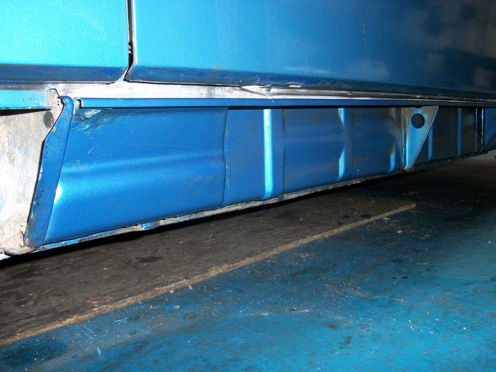

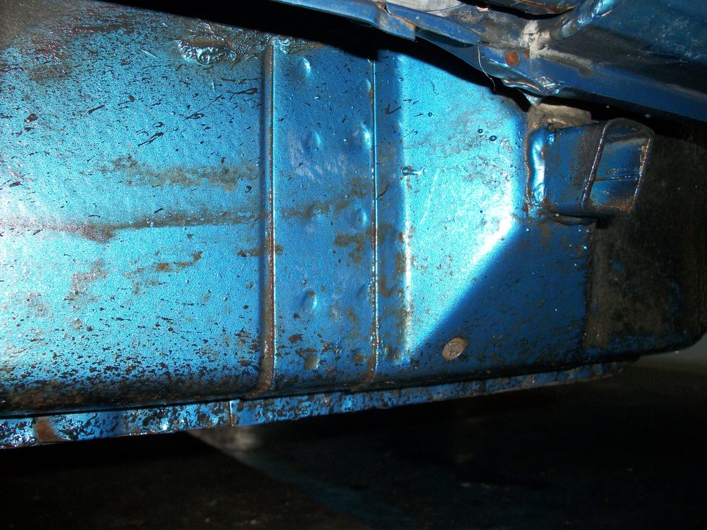

So, now came the moment of truth, taking the sill covers off…
Everyone I’d spoken to when saying that I had found no rust (apart from the battery tray) on my car, just smiled and said “wait until you take off the sill covers and reveal the jacking points”
To say they were full of sand was an understatement. I got almost half a bucket full out of each side, plus more Californian spiders nests and webs.
Again I used a soft handbrush (from my brush and pan) then a damp cloth to wipe the final dusty sand residue off and found them like this…
(IMG:http://www.914world.com/bbs2/uploads_offsite/i265.photobucket.com-18255-1451512155.32.jpg)
The jack points are a little dirty and I will have to give them a T-cut just to make them factory new again. (The door bottoms are rust free, that's just dirt & water stains showing in the camera flash)
(IMG:http://www.914world.com/bbs2/uploads_offsite/i265.photobucket.com-18255-1451512155.33.jpg)
There’s a bit of scratching down the jack tube, but most of the blue paints still in there. As per the rest of the car, I couldn’t find any rust to write about.
The lower vertical spot weld seam on the base of the sill has a few bits of chipped paint on it so I’ll touch them in with a small brush.
Apart from a T-cut I think I’ll get the paint shop just to mask them up and not paint them. I quite like the idea of keeping the original paint on them. Maybe a coat of clear Waxoil would be enough to preserve the surface for UK weather.
At least today was a result and redeemed some of yesterday’s frustration with the brake disc saga!
