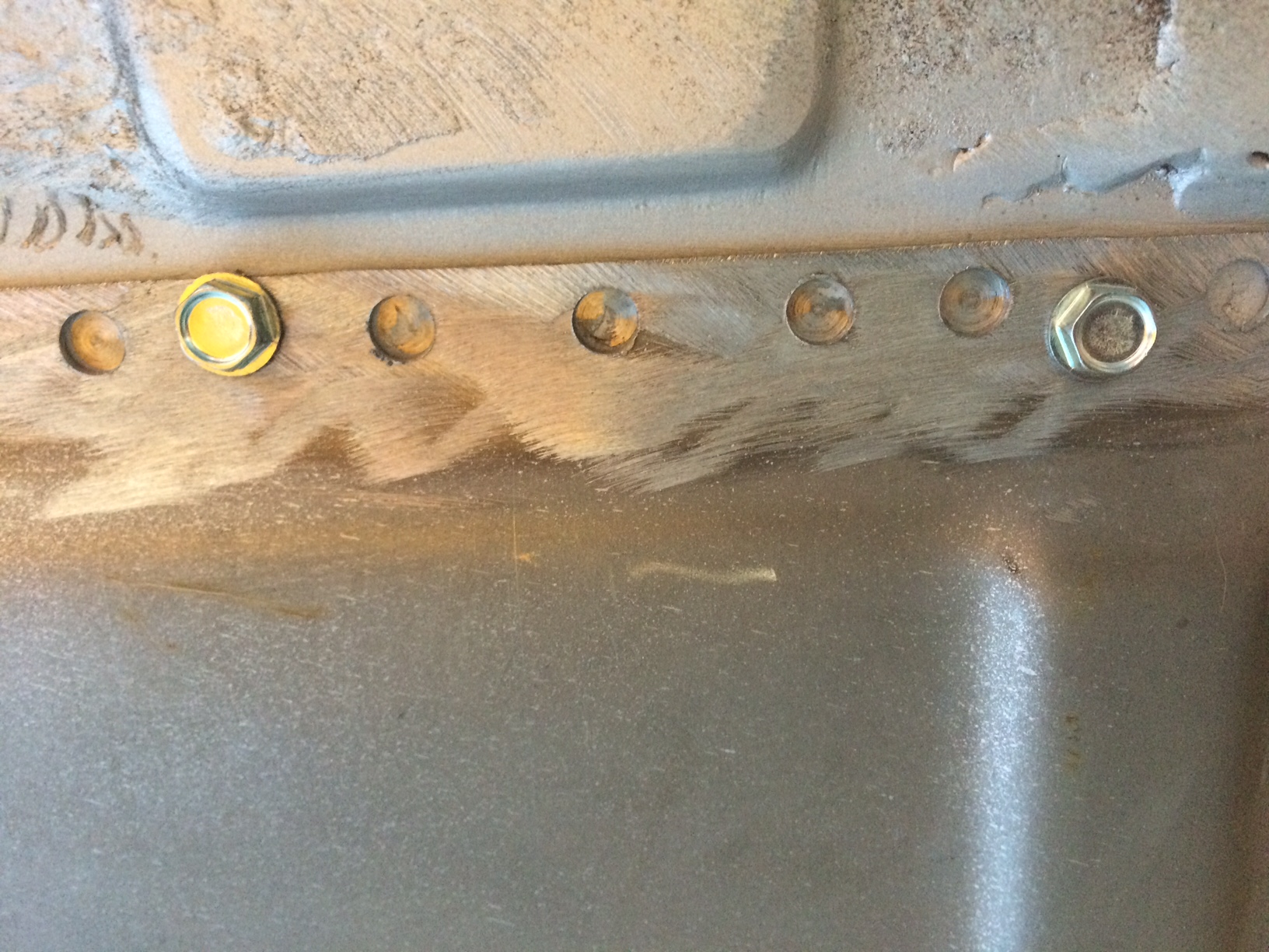

post Dec 31 2015, 06:06 PM
Posts: 5,803
Joined: 6-October 15
From: Petaluma, CA
Member No.: 19,241
I applied weld through primer between all the panels. I'm really after improving my metal working/finishing skills so to make the rosette welds as nice as possible, I wanted to eliminate the spatter I get from the primer. So, I flatted the tip on one of the 7/16 spot weld drill bits and used it to remove the primer from each of the holes.
Hard to tell from the pic but I have nice clean, bare metal for the welds!
Too anal? I don't think so!
