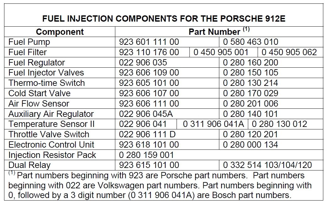

That's a good start Mike. I quickly checked a few of the part numbers - several I could not easily ID - others included a bus AFM.
The throttle body and air plenum under it look they might be 914 2.0L parts - they would be too big for a 1.7L engine. Not sure about the intake manifold runners.
You will also need a 1.7L ignition harness, unless you have one already?
Be a good idea to now make a list of the parts you need and work with Brice Stone to put the whole package together.
Here is a partial list of 912E FI parts:
