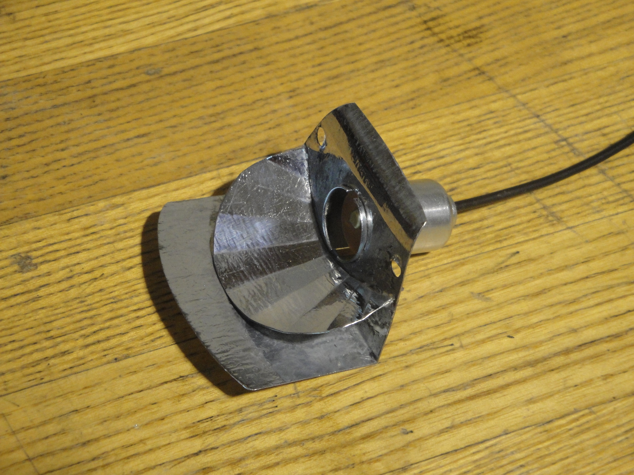

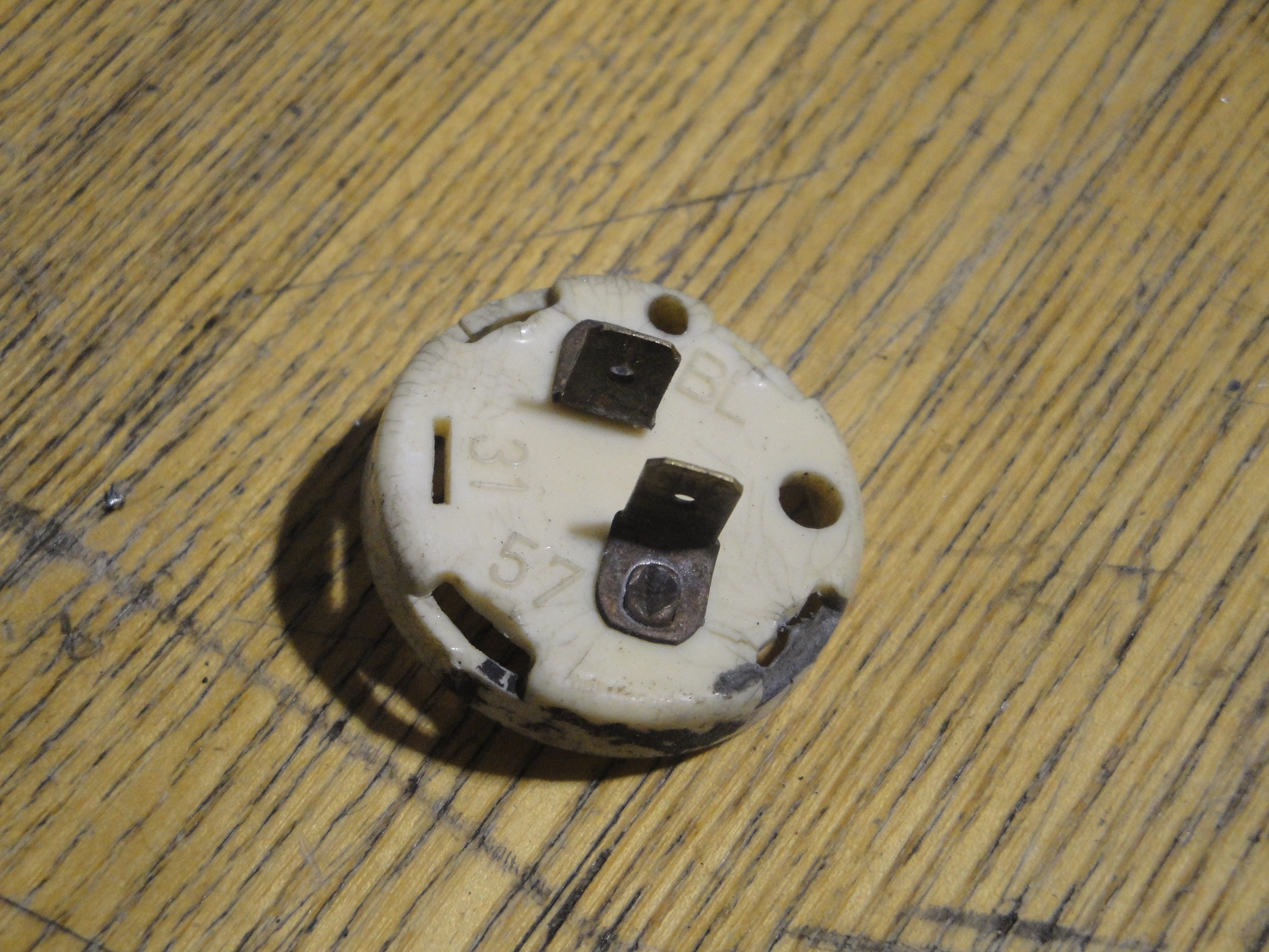

Here is the photos for the DIY folks, thanks to them. I will start by saying this, don't wire up the socket with the type 89 bulb in the socket. You will need the slack in the wire or it could break under tension.
To start remove the housings wire terminal white cap. Use a long flat object to pop it off, to be 100% honest, I use a large flat file. It works perfect. Be very gentle, this plastic is old. And brittle. Take your time. Work it a little all the way around the circumference, not all at once, or it will break. You can also put a little heat on it with a heat gun to make it a little more pliable. USE COMMON SENSE.

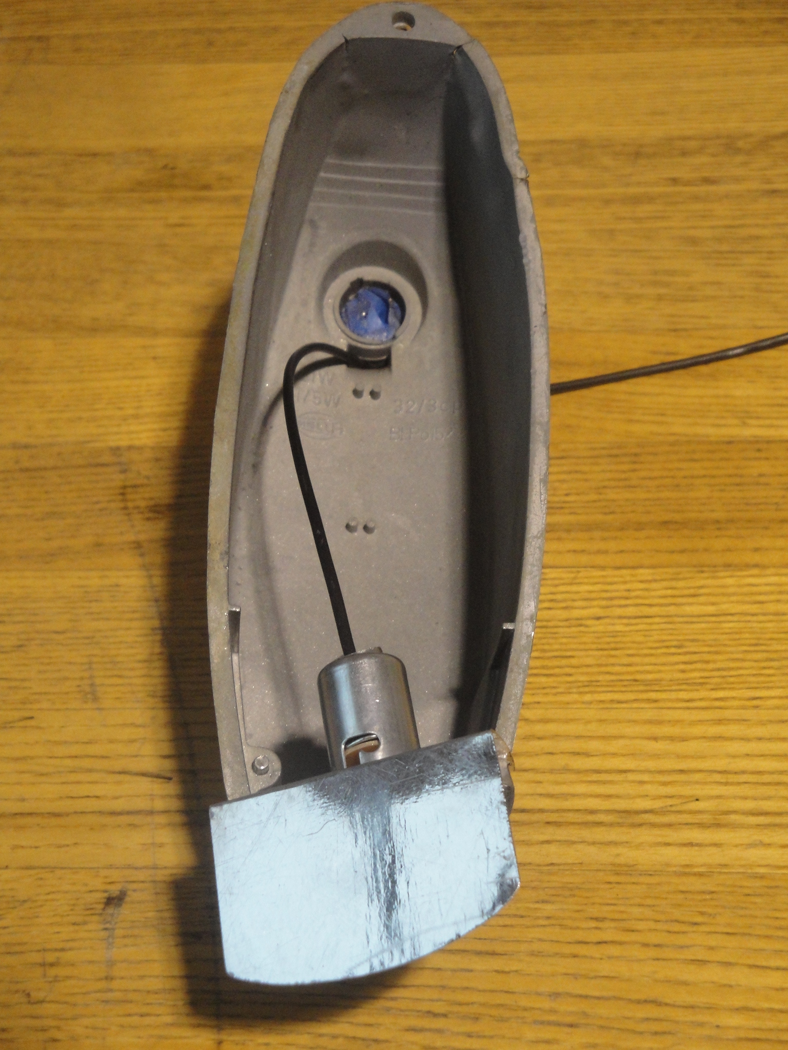

Before the refractor is seated you will need to stretch the insulation on the wire. Do this with the tip of your index and thumb of both hands. It will get hot if you do it right. It needs to be thinner to fit the pins that retain it in the housing. Grab it at the base of the socket and stretch it toward the end. It will fit between the retaining pins much better.
Run the wire through the slot forward of the socket for the 1157 bulb.
Set the refractor in the housing. It should fit tight. If its a little loose in your housing, squeeze it a bit to get a better fit. I have a housing here I use to fit everyone, it is undamaged. They are all a bit different after 40 years.
