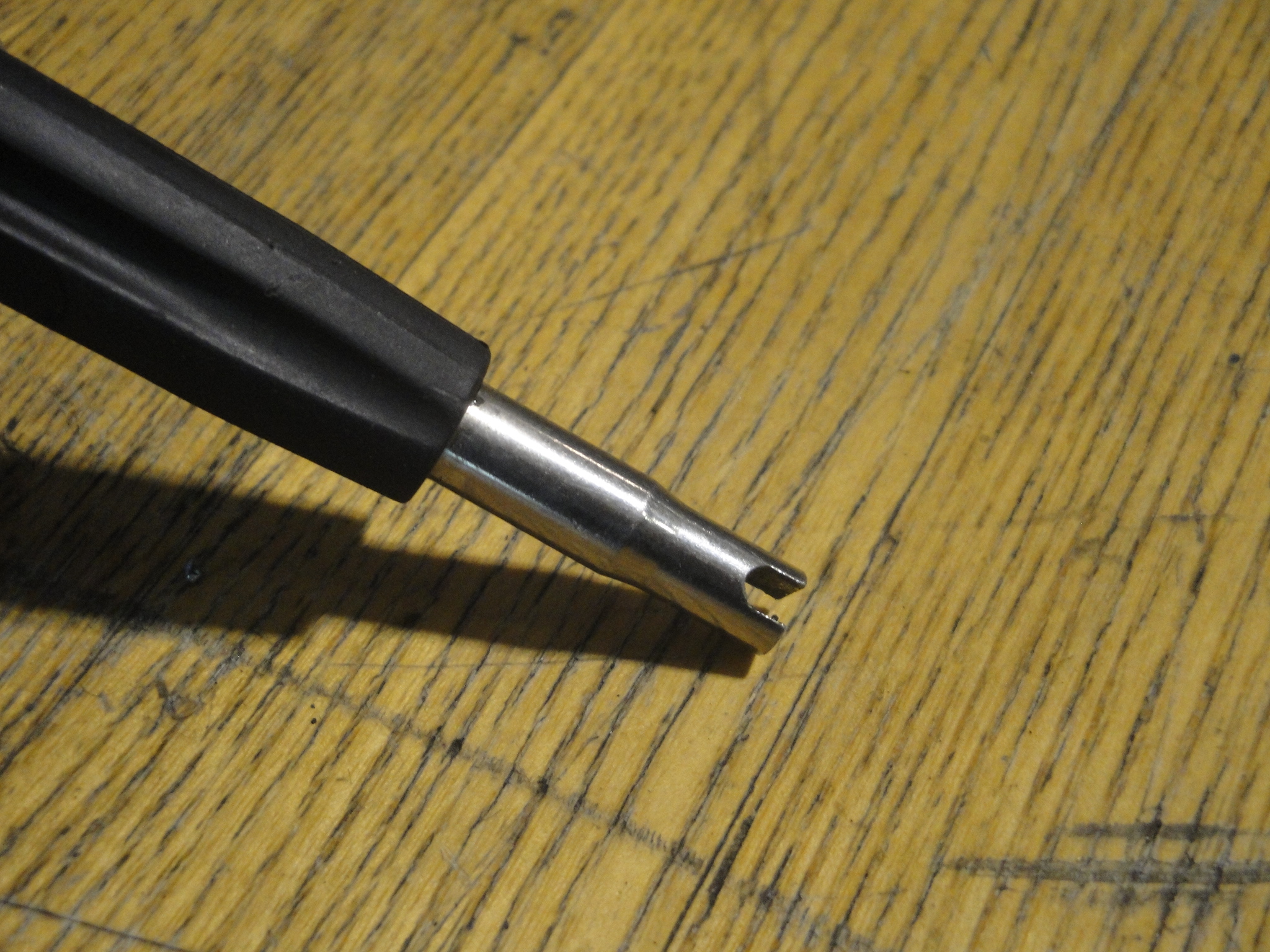

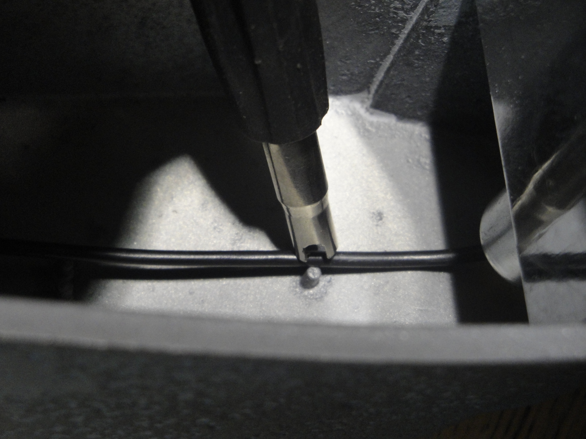

After the refractor is set in place, with the bulb removed, set the power wire. I use the big end of a valve core tool. You do not want to nick the wire. AVOID sharp tools.
If you damage the wire it will short against the housing. Start at the refractor end, keeping just a bit of tension on the wire, so it stays nice and straight down the run, don't make it like a guitar string.
