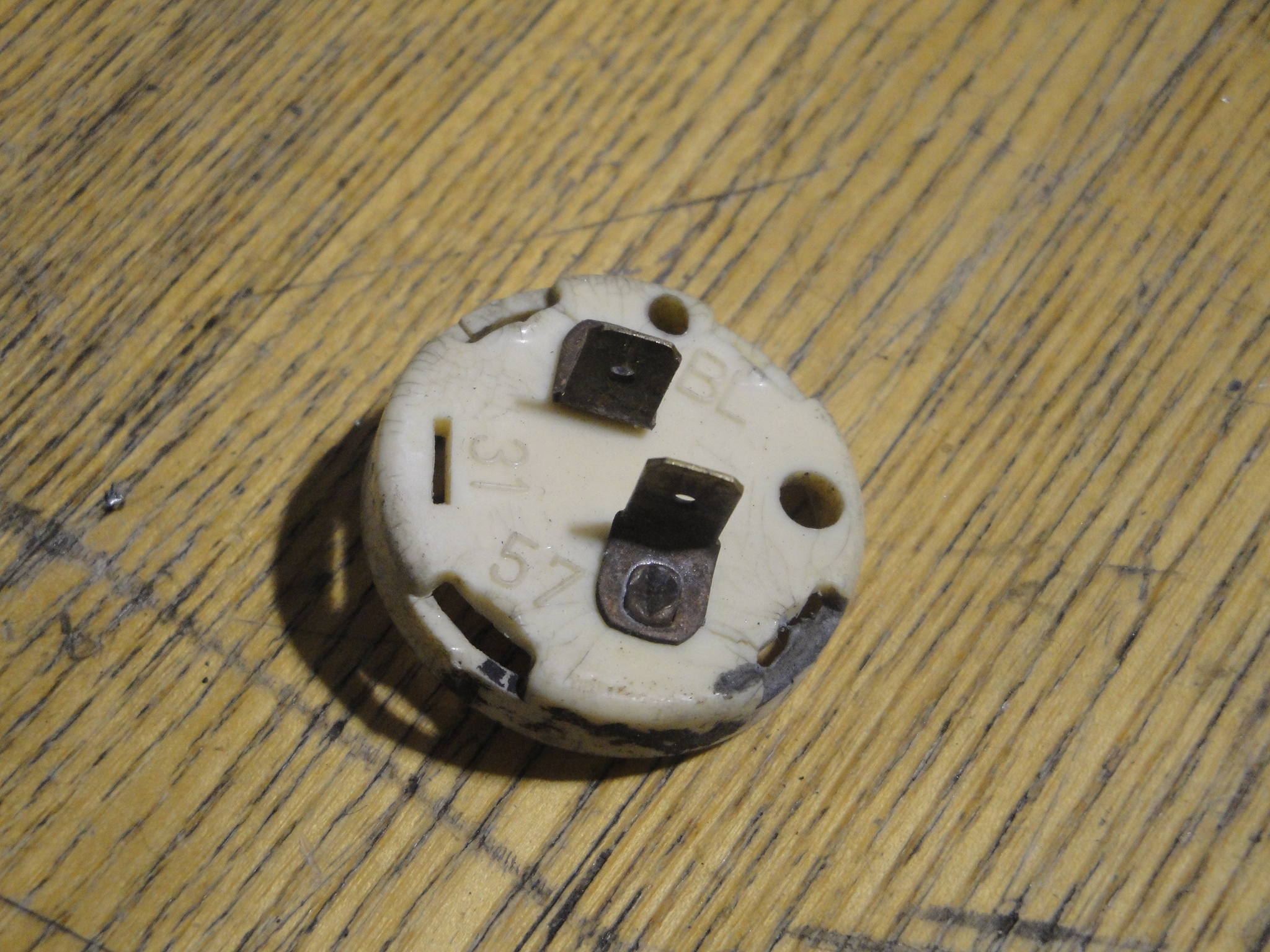

So now this is the important stuff. You will cut terminal 57 on the terminal cap. Of course you will have had to removed that earlier. It will look like this. MAKE SURE YOU CUT THE 57 TERMINAL. The BL terminal is Blinker. 31 is the ground.
The terminal seen here is really bad, hopefully yours are better. You can repair them, but having a spare or two is a good thing.

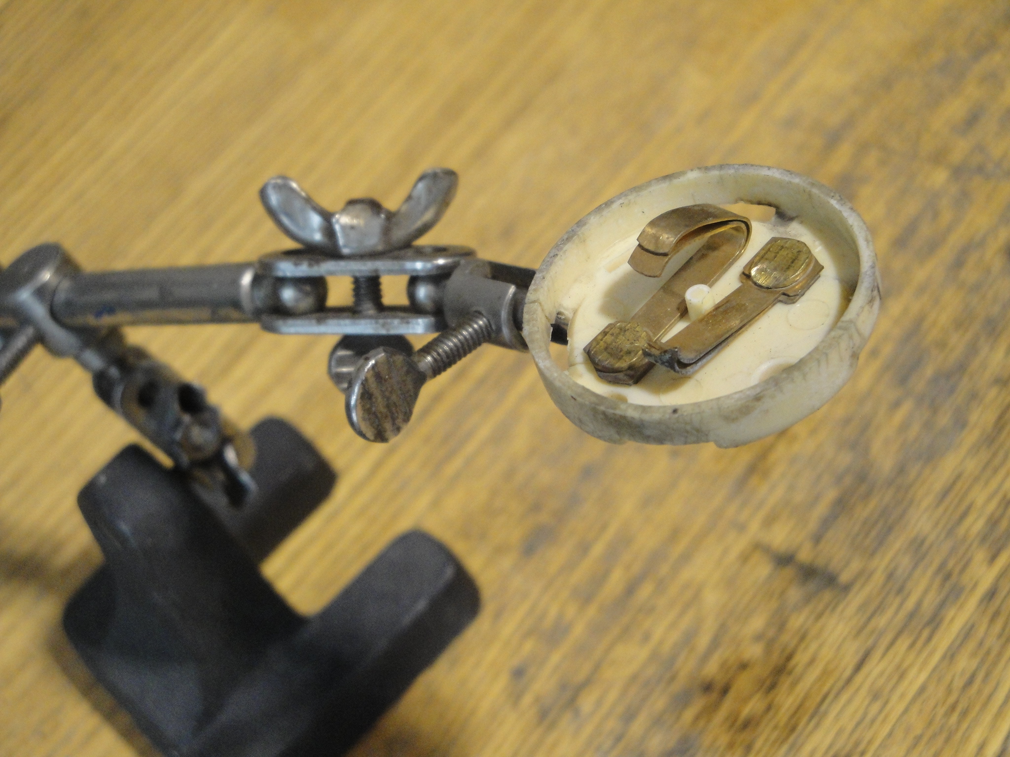

Martin Baker   So now this is the important stuff. You will cut t...   Jan 5 2016, 02:20 PM
Martin Baker   With the 57 terminal cut as shown, and your wire c...   Jan 5 2016, 02:31 PM
Martin Baker   Next solder up your connection. The direction you ...   Jan 5 2016, 02:38 PM
