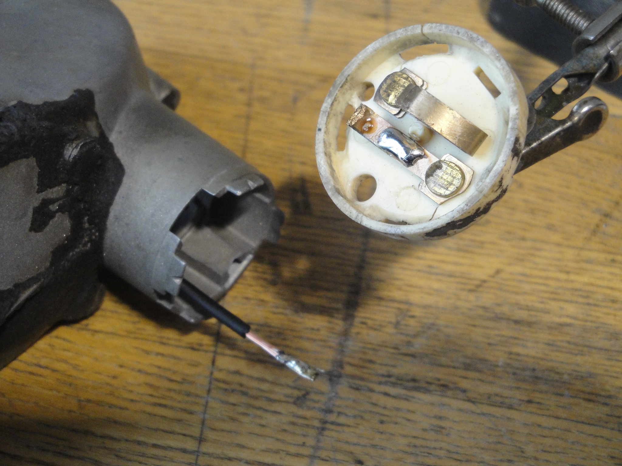

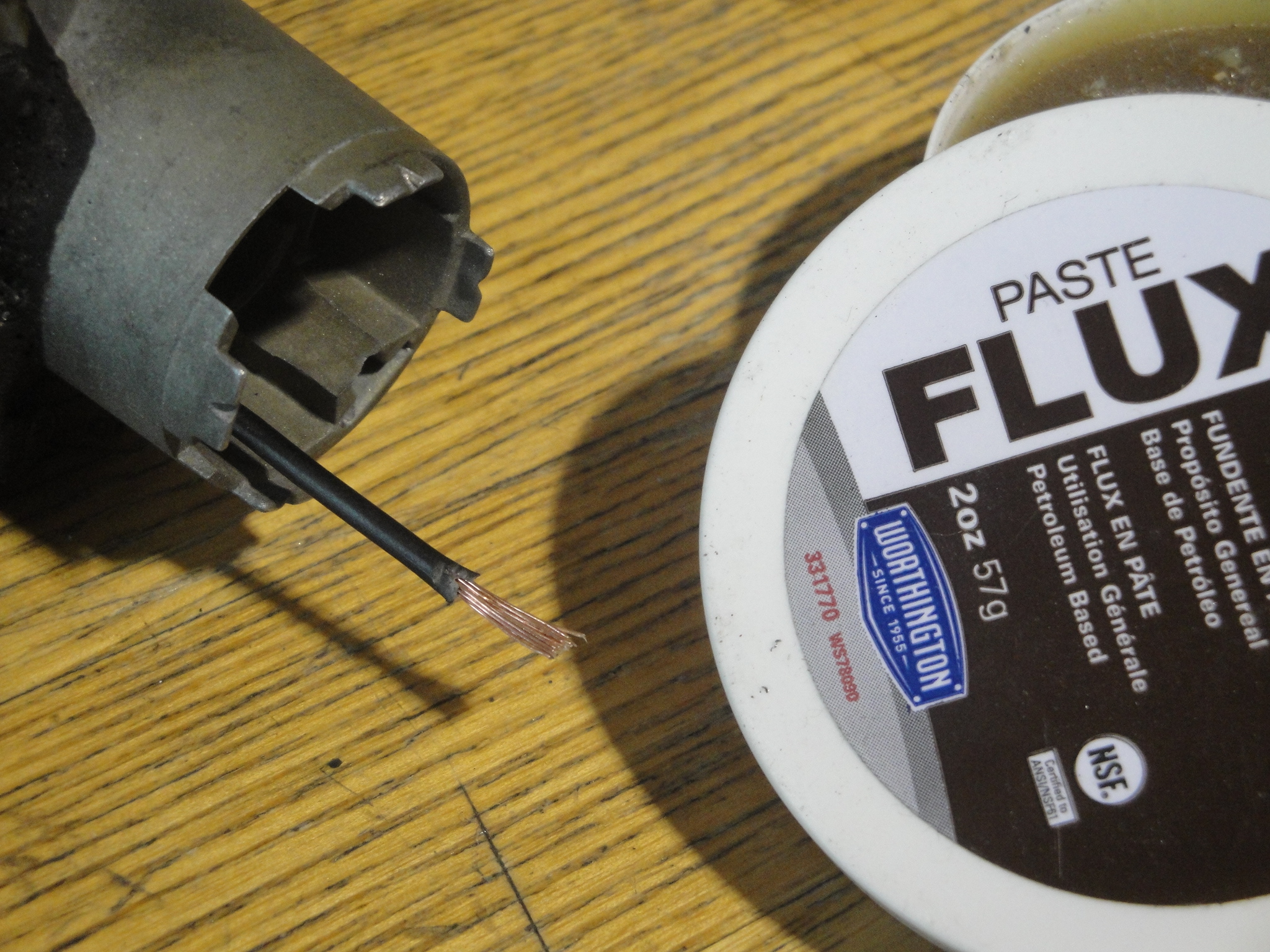

With the 57 terminal cut as shown, and your wire cut and striped back just slightly, use a soldering iron to tin both. Its critical. In the photo here I cut back to much insulation. I redid this but did not re take the photo. You want insulation down right to the solder joint. If you don't, it will cause an internal short.
