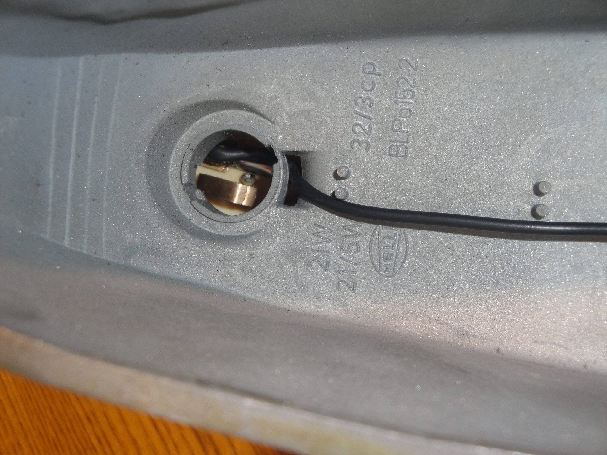

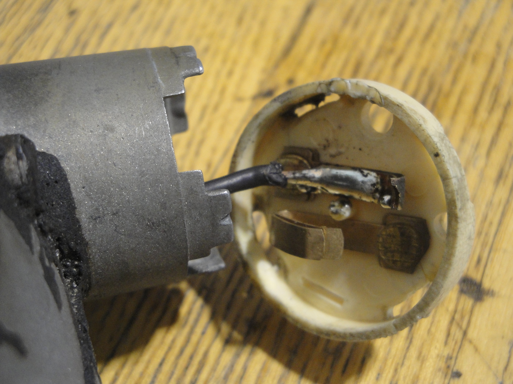

Next solder up your connection. The direction you come in is critical. Be careful of the plastic on the terminal cap. Don't melt it. Come in from behind the rivet holding the 57 terminal. Use a heat sink, like my extra hands. Once connected, I use a small rubber hammer to tap the terminal back on to the housing. Be gentle, use common sense here as well. Just tap it on, and work your way around. Pay attention to the wire, as it will need to remain clear of the remaining terminal inside for the 1157 bulb. See photo. You will notice the wire is not set in the photo, its because this unit will eventually be sold. I used it for demo only.
