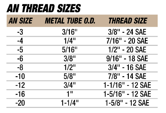

I need to have some fittings machined and wanted to know what the factory 914-6 oil tank fittings are suppose to be?

I can see why PMS went with M22. You can readily find fittings to adapt the stock metric lines and custom lines with AN fittings in 22mm. I'd think AN-12 would be perfect (it's about 30mm). AN-16 is pretty big at 1 5/16"
http://www.elephantracing.com/oilhandling/.../911adapter.htm

mb911   I am ordering fittings today have all of you decid...   Jan 7 2016, 08:49 AM
Mark Henry   I am ordering fittings today have all of you deci...   Jan 7 2016, 09:06 AM
mb911   I am ordering fittings today have all of you dec...   Jan 7 2016, 09:13 AM
jd74914   I like the ideal of female standard fittings a wel...   Jan 7 2016, 11:20 AM
jmill   I can see why PMS went with M22. You can readily ...   Jan 7 2016, 12:45 PM
jmill   You could just leave it at that, as there is metr...   Jan 7 2016, 01:11 PM
mb911   You could just leave it at that, as there is met...   Jan 7 2016, 07:36 PM
jmill   We should just do yours in straight AN way easier...   Jan 7 2016, 08:53 PM
mb911   Ok I have researched it like crazy 22mm is the bes...   Jan 9 2016, 11:54 AM
