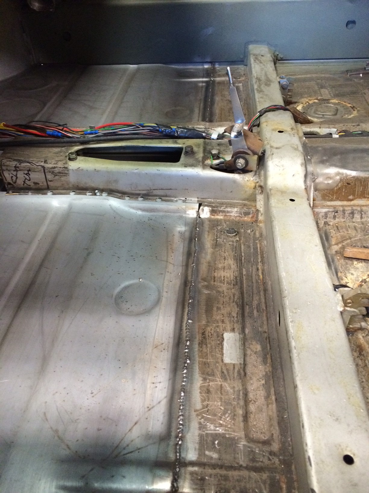

Finished my buddy's 911 roll cage and finally got some time on my own car! (IMG:style_emoticons/default/welder.gif) Completed the rear seam butt weld... well, nearly complete, anyway. One minor gap to close but it's turning out nicely. Seam should all but disappear after the weld is ground. That's the plan anyway...!

tygaboy   Finished my buddy's 911 roll cage and finally ...   Jan 10 2016, 08:01 PM
