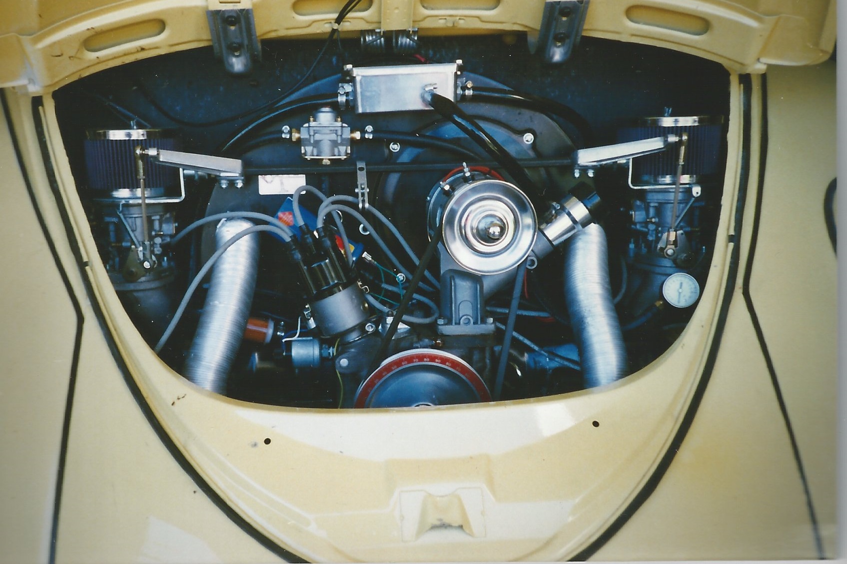

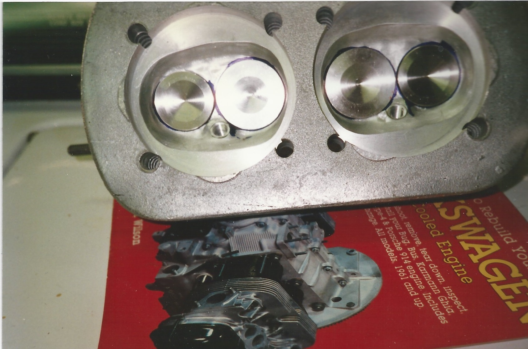

QUOTE(J P Stein @ Jan 12 2016, 09:45 AM) *
The T-4 short, eh?....right. They are such a high demand engine (IMG:style_emoticons/default/rolleyes.gif)
Actually it was a Type I. Big difference between drags and autocross. You lift. Doubt you had Chevy 2.02 intake valves either.
