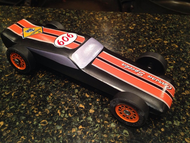

We did a wedge last year. I'm sure flatter/simpler is going to be better but we went for more style this year. Last year someone built a semi truck looking thing and it was fast too.
Here is our finished car for this year. I just pressed the wheels in last night. We have a car show tonight. The derby is the 23rd. I still need to tune the axles. I drilled them with a 3 degree cant, but one is not straight. The car rides on 3 wheels and I will tune it to rail ride.
