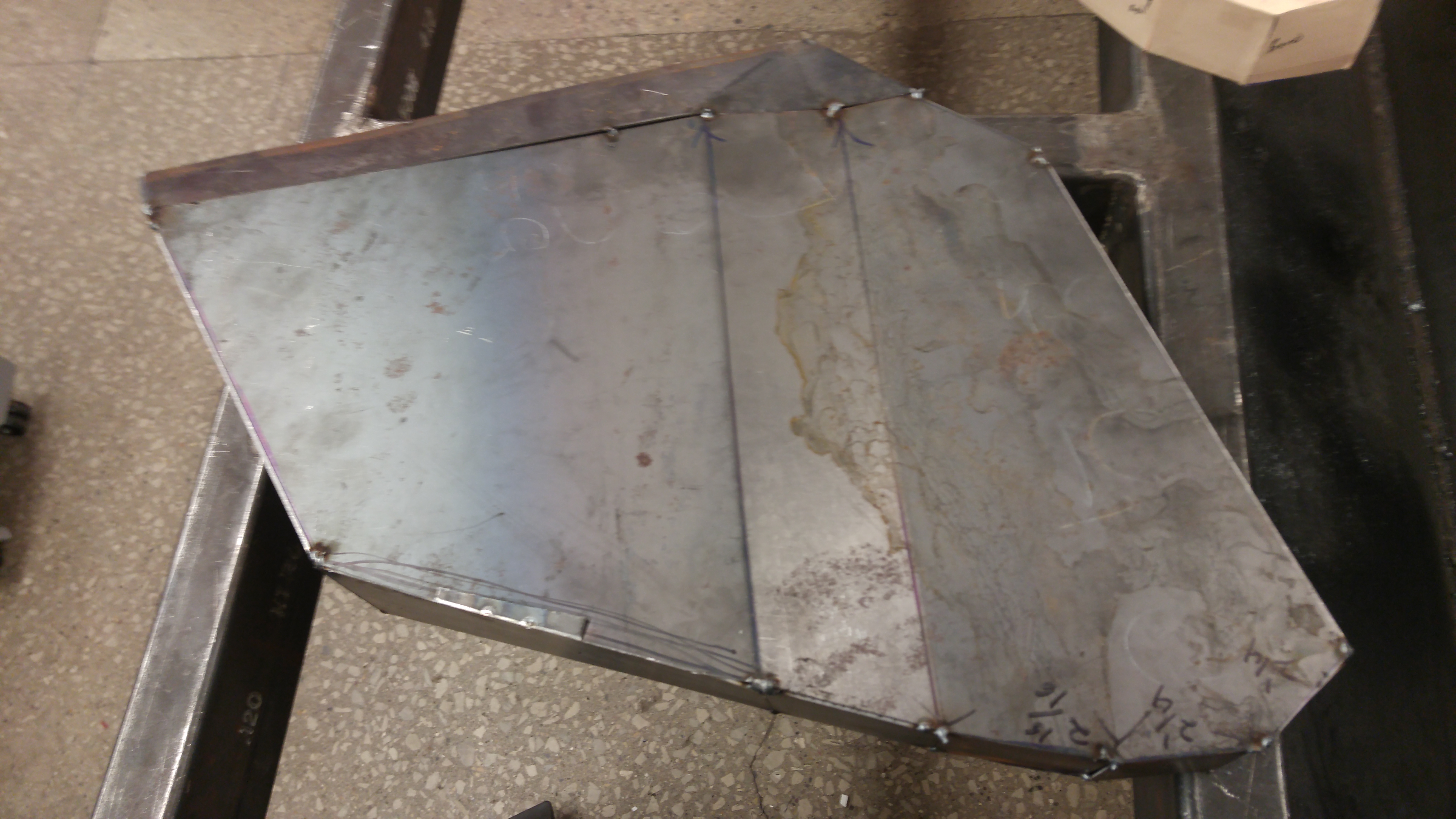

So quick update this is the final transfer pattern made of steel . I will triple check fittment, add hole locations, add mounting stud locations and then grind the tacks out and I will have my patterns and can nest the layouts on the aluminium for the first run of tanks.. Still will meet my expected completion by the end of the month and will be taking orders shortly. Gotta launch the website shortly..
