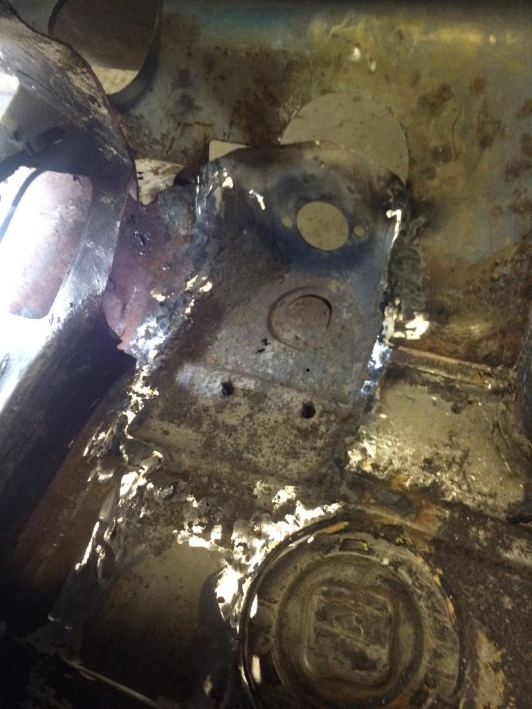

At long last i'm back welding .... so the pedal floor pan is in place and going nowhere ! next is the hand brake cable guide tubes, hand brake lever mount and dimple then the bulkhead ...
