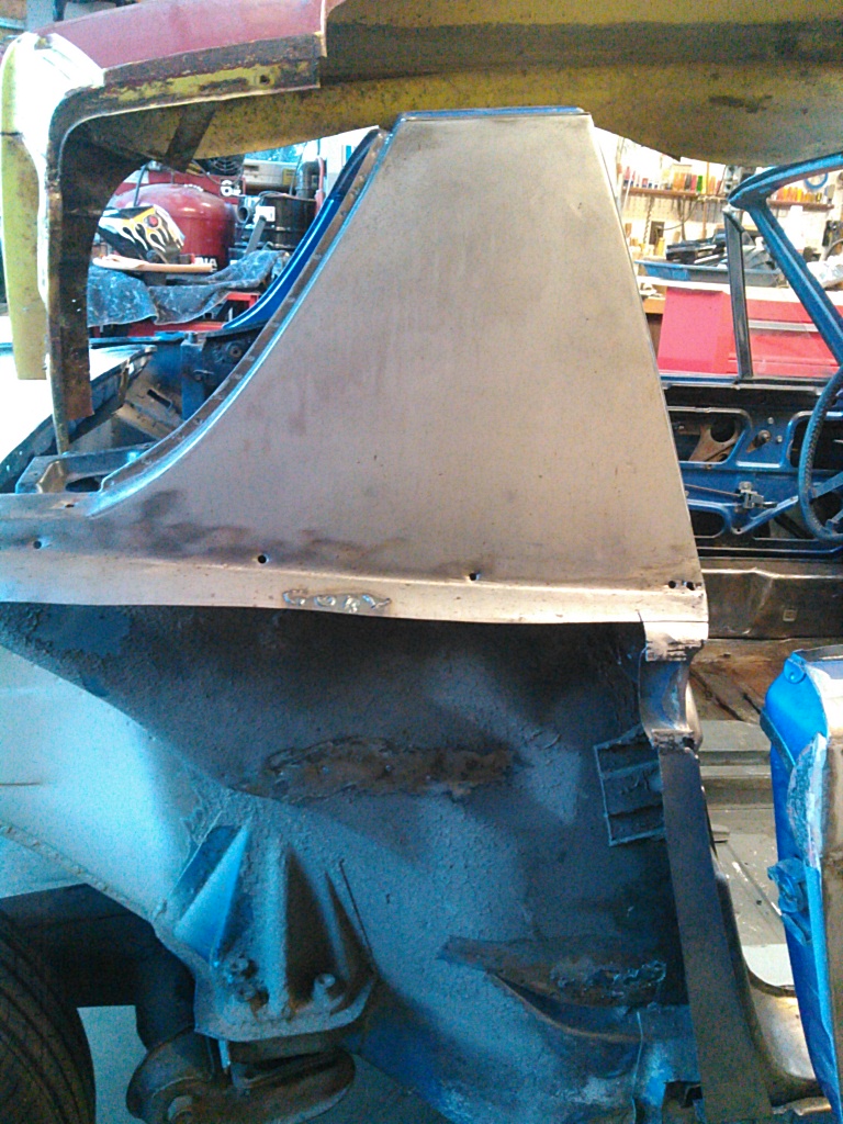

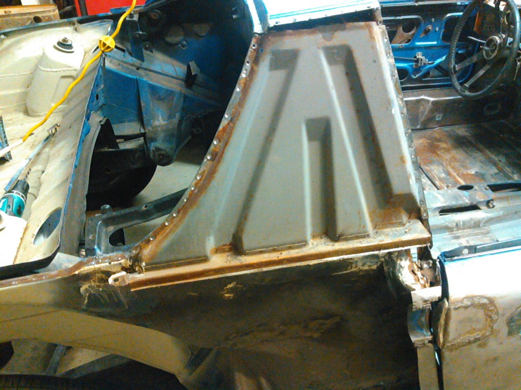

Got the 1/4 started. Not bad at all. A little rust at the vent tube. Such a shame the crack heads with a ark welder decided to fill door handles. (we need a crack head with a ark welder smile)
