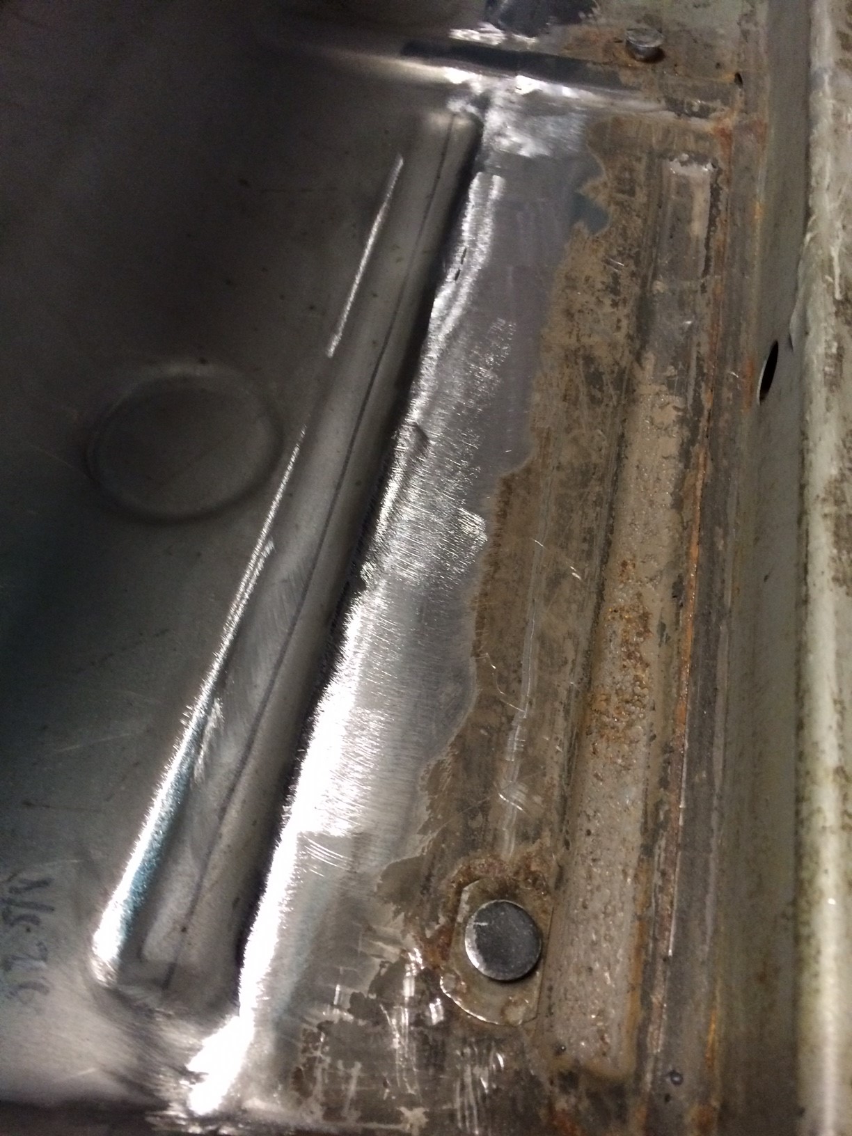

Little bit of (IMG:style_emoticons/default/welder.gif) and the front floor half is in. I'm working to up my welding skills to metal finish on all my butt welds. And even though one side of this will be under sound proofing and carpet and the other side will be undercoated, it was great practice. I'm happy with how it turned out.
