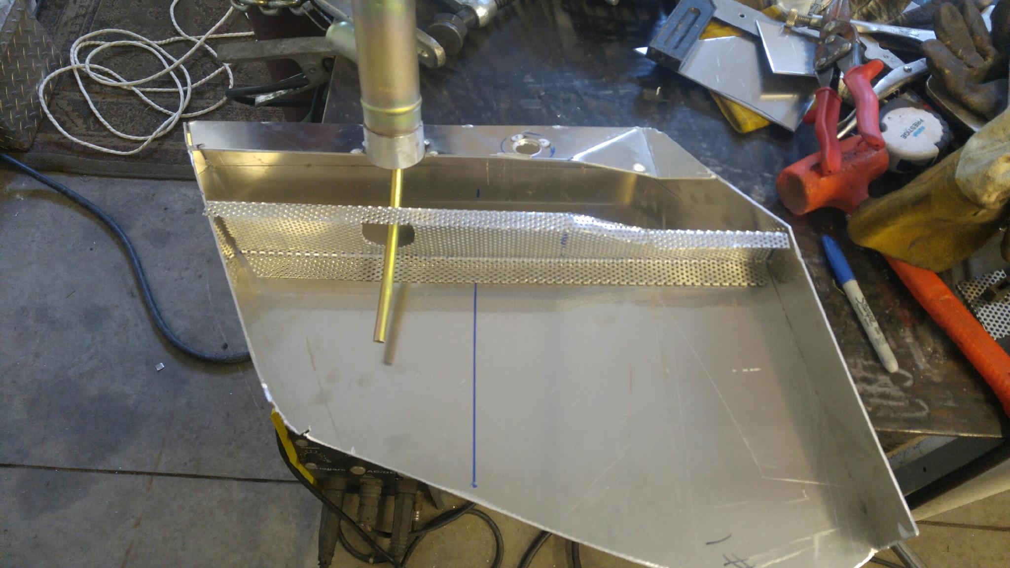

mb911   here is a rough template. I will test fit over the...   Dec 15 2015, 11:03 AM
jmill   Looking good. If you're going to mass produce...   Dec 15 2015, 04:38 PM
mb911   Looking good. If you're going to mass produc...   Dec 15 2015, 07:11 PM
mb911   Looking good. If you're going to mass produ...   Dec 16 2015, 06:22 AM
mb911   Looking good. If you're going to mass produ...   Dec 16 2015, 10:46 AM
mb911   Ok another question for all of you. The oil line ...   Dec 16 2015, 06:22 PM
mb911   Here is the first revision to the plug/template an...   Dec 17 2015, 10:42 AM
mb911   and a comparison. may still need to revise more bu...   Dec 17 2015, 11:51 AM
mb911   Ok another update. The revision fits in perfect.. ...   Dec 17 2015, 02:30 PM

brant   tank looks good I made the same one about 5 years...   Dec 17 2015, 03:10 PM
mb911   It's ok I needed to do it from scratch for a s...   Dec 17 2015, 03:15 PM
brant   I kept the internal baffling and internal screen b...   Dec 17 2015, 03:58 PM
Eric_Shea   A drain cock would be much appreciated. Excellent...   Dec 17 2015, 04:23 PM
mb911   A drain cock would be much appreciated. Excellen...   Dec 17 2015, 05:04 PM
Eric_Shea   I can send you one. This is what I was thinking. ...   Dec 17 2015, 06:02 PM
mb911   I can send you one. This is what I was thinking....   Dec 17 2015, 06:32 PM
brant   pictures of the one I made about 8 years back.. a...   Dec 17 2015, 07:21 PM
brant   and   Dec 17 2015, 07:22 PM
brant   last:   Dec 17 2015, 07:23 PM
mb911   It's hard to tell from the picture but is that...   Dec 17 2015, 07:30 PM
brant   It's hard to tell from the picture but is tha...   Dec 17 2015, 07:57 PM

mb911   Another question for you is of all the tanks out t...   Dec 27 2015, 02:26 PM
Eric_Shea   No issues whatsoever...   Dec 28 2015, 12:14 PM
Mark Henry   Is that screen stainless steel? or what is it mad...   Dec 28 2015, 01:40 PM
mb911   Is that screen stainless steel? or what is it ma...   Dec 28 2015, 01:57 PM
jmill   If you do install a baffle I would recommend a dif...   Dec 28 2015, 01:56 PM
mb911   If you do install a baffle I would recommend a di...   Dec 28 2015, 02:06 PM
sixnotfour   .750 would be an improvement .. and make filter co...   Dec 28 2015, 02:00 PM
mb911   .750 would be an improvement .. and make filter c...   Dec 28 2015, 02:03 PM
jmill   You can add tabs. Cut two slots in the backside a...   Dec 28 2015, 02:22 PM
jmill   Ugly pic but you'll get the idea.   Dec 28 2015, 02:29 PM
Mark Henry   I'm less concerned with the baffle, as long as...   Dec 28 2015, 02:55 PM
mb911   I'm less concerned with the baffle, as long a...   Dec 28 2015, 03:35 PM
mb911   I'm less concerned with the baffle, as long ...   Jan 4 2016, 03:23 PM

mb911   I used baffle specd by customer production units w...   Jan 17 2016, 06:09 PM
mb911   Tank ready for -12 weld on bungs   Jan 17 2016, 06:10 PM
