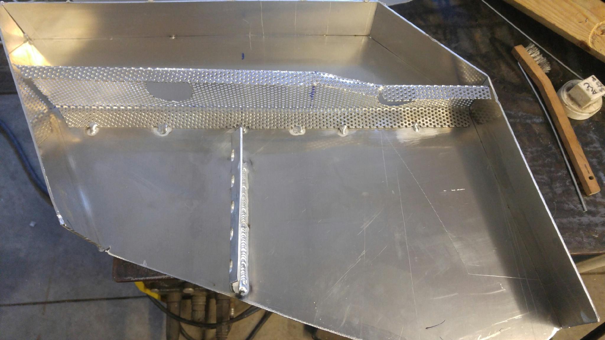

I used baffle specd by customer production units will have the perffed material like used in the upper portion of the tank

mb911   I used baffle specd by customer production units w...   Jan 17 2016, 06:09 PM
mb911   Tank ready for -12 weld on bungs   Jan 17 2016, 06:10 PM

mb911   Here is number 1 of the oil tanks with oil filter ...   Feb 8 2016, 12:47 PM
