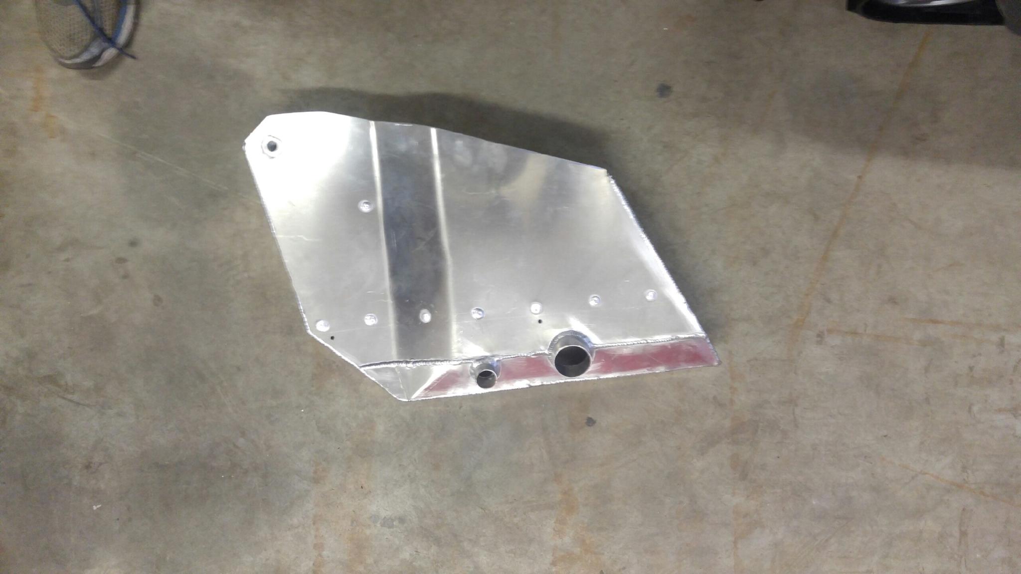

Guys,
I need to have some fittings machined and wanted to know what the factory 914-6 oil tank fittings are suppose to be?

Tank ready for -12 weld on bungs

mb911   here is a rough template. I will test fit over the...   Dec 15 2015, 11:03 AM
jmill   Looking good. If you're going to mass produce...   Dec 15 2015, 04:38 PM
mb911   Looking good. If you're going to mass produc...   Dec 15 2015, 07:11 PM
mb911   Looking good. If you're going to mass produ...   Dec 16 2015, 06:22 AM
mb911   Looking good. If you're going to mass produ...   Dec 16 2015, 10:46 AM
mb911   Ok another question for all of you. The oil line ...   Dec 16 2015, 06:22 PM
mb911   Here is the first revision to the plug/template an...   Dec 17 2015, 10:42 AM
mb911   and a comparison. may still need to revise more bu...   Dec 17 2015, 11:51 AM
mb911   Ok another update. The revision fits in perfect.. ...   Dec 17 2015, 02:30 PM

brant   tank looks good I made the same one about 5 years...   Dec 17 2015, 03:10 PM
mb911   It's ok I needed to do it from scratch for a s...   Dec 17 2015, 03:15 PM
brant   I kept the internal baffling and internal screen b...   Dec 17 2015, 03:58 PM
Eric_Shea   A drain cock would be much appreciated. Excellent...   Dec 17 2015, 04:23 PM
mb911   A drain cock would be much appreciated. Excellen...   Dec 17 2015, 05:04 PM
Eric_Shea   I can send you one. This is what I was thinking. ...   Dec 17 2015, 06:02 PM
mb911   I can send you one. This is what I was thinking....   Dec 17 2015, 06:32 PM
brant   pictures of the one I made about 8 years back.. a...   Dec 17 2015, 07:21 PM
brant   and   Dec 17 2015, 07:22 PM
brant   last:   Dec 17 2015, 07:23 PM
mb911   It's hard to tell from the picture but is that...   Dec 17 2015, 07:30 PM
brant   It's hard to tell from the picture but is tha...   Dec 17 2015, 07:57 PM

mb911   I am ordering fittings today have all of you decid...   Jan 7 2016, 08:49 AM
Mark Henry   I am ordering fittings today have all of you deci...   Jan 7 2016, 09:06 AM
mb911   I am ordering fittings today have all of you dec...   Jan 7 2016, 09:13 AM
jd74914   I like the ideal of female standard fittings a wel...   Jan 7 2016, 11:20 AM
jmill   I can see why PMS went with M22. You can readily ...   Jan 7 2016, 12:45 PM
jmill   You could just leave it at that, as there is metr...   Jan 7 2016, 01:11 PM
mb911   You could just leave it at that, as there is met...   Jan 7 2016, 07:36 PM
jmill   We should just do yours in straight AN way easier...   Jan 7 2016, 08:53 PM
mb911   Ok I have researched it like crazy 22mm is the bes...   Jan 9 2016, 11:54 AM
mb911   So quick update this is the final transfer pattern...   Jan 13 2016, 07:18 PM
mb911   1st one for jmill and remote oil filter set up   Jan 17 2016, 06:06 PM
mb911   I used baffle specd by customer production units w...   Jan 17 2016, 06:09 PM
mb911   Tank ready for -12 weld on bungs   Jan 17 2016, 06:10 PM
