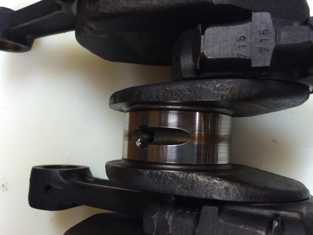

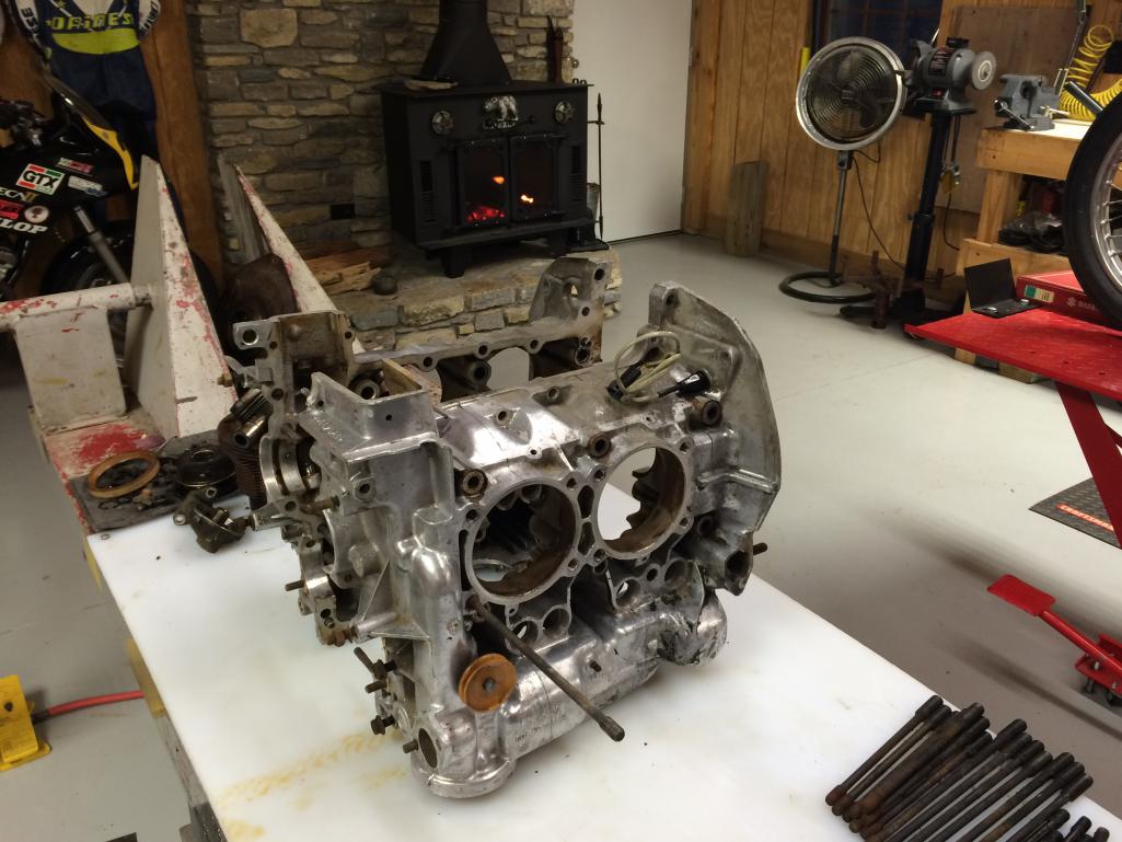

Today's progress. Cleaned case halves (to the best of my abilities)...
Crank doesn't look too bad...
Next step is to send these case halves out to a pro for measuring and align-boring and decking (if needed)...

sdoolin   Unusual damage to #4 cylinder deck. I must not be ...   Jan 17 2016, 06:19 PM
sdoolin   Case halves don't look too too bad...   Jan 17 2016, 06:23 PM
