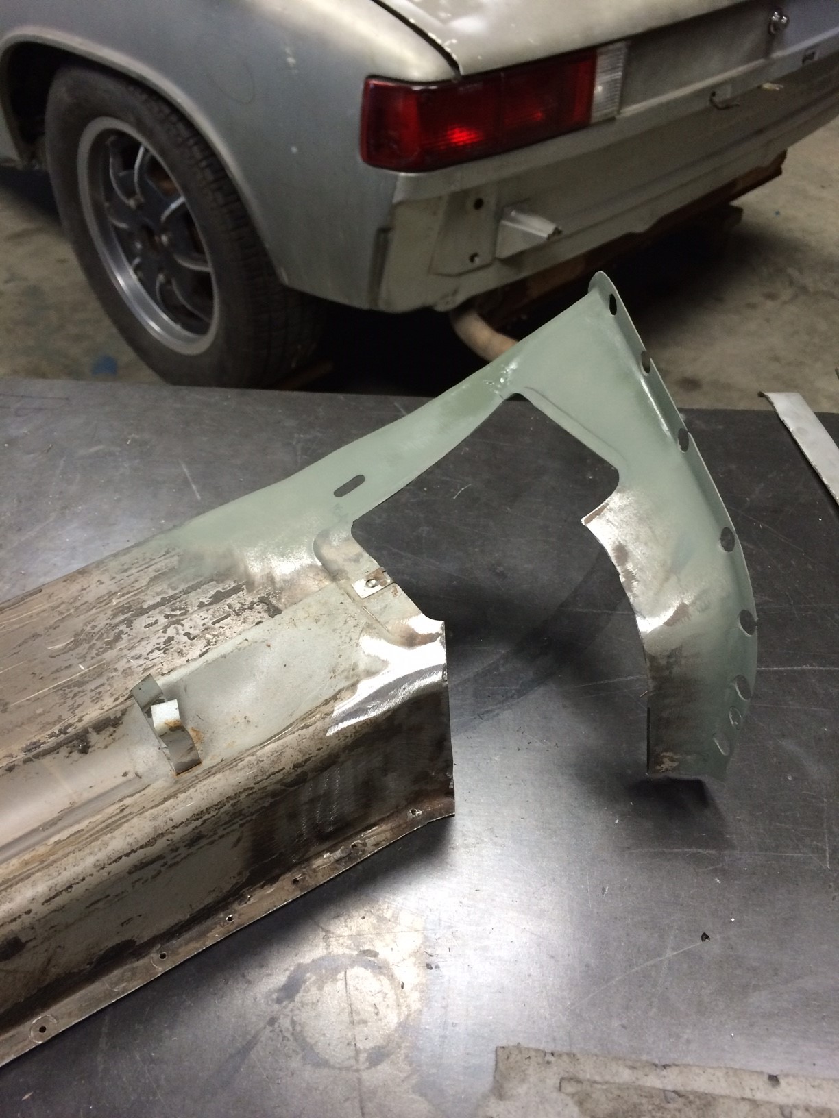

Part of the floor repair includes a fix to the tunnel. No idea what the PO was thinking/doing but there were some gaks that I had to fix. I decided that it would be far simpler if I did the repair with the tunnel, or at least part of it, out of the car.
With 1/2 the floor already out, I figured, why not. More welding practice ahead of tackling the flares.
So, here's what I started with. Gotta get better at the entire "before" picture taking. Anyway...Attached Image
