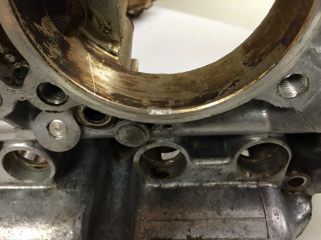

Unusual damage to #4 cylinder deck. I must not be the first one in here which is a little strange because this engine came from a single owner bus that I purchased 30 some years ago...

sdoolin   Unusual damage to #4 cylinder deck. I must not be ...   Jan 17 2016, 06:19 PM
