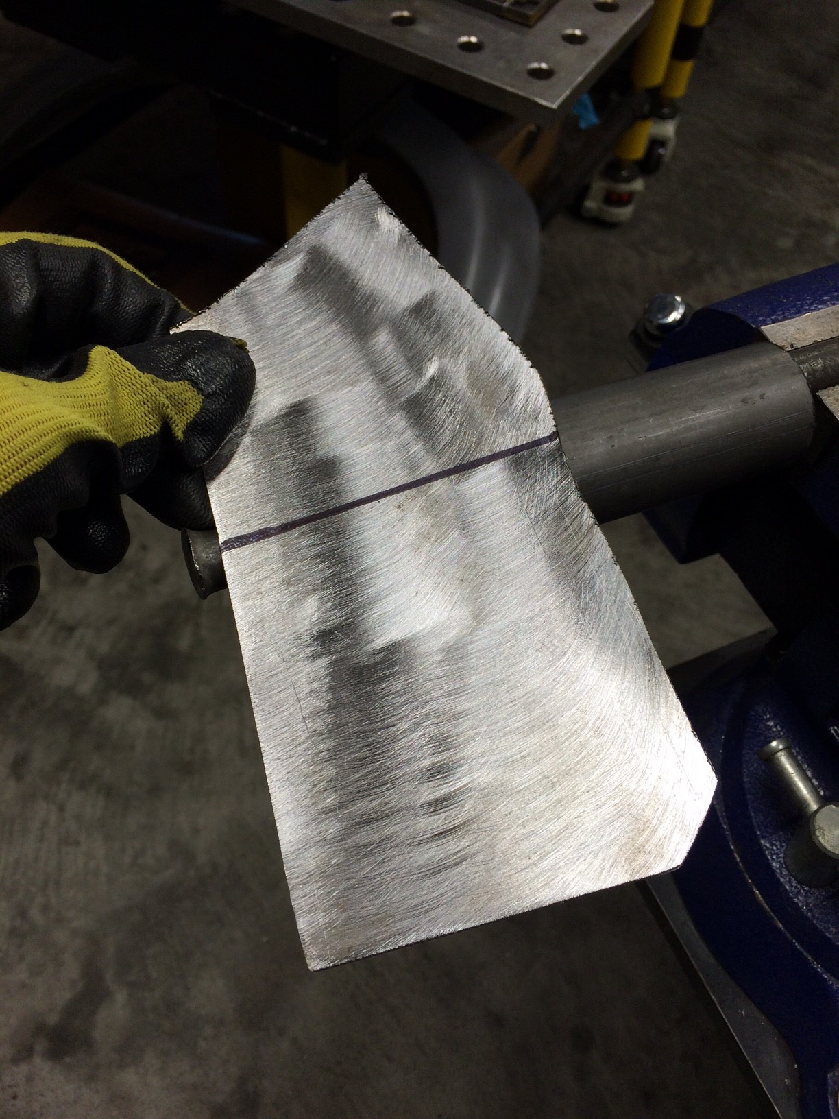

tygaboy   Part of the floor repair includes a fix to the tun...   Jan 17 2016, 06:17 PM
tygaboy   Next, I had to fab the patch. Different radius on ...   Jan 17 2016, 06:19 PM
tygaboy   rough cut the patch, figure where the radius needs...   Jan 17 2016, 06:20 PM
tygaboy   Ta da. Just like I'd hoped!   Jan 17 2016, 06:21 PM
tygaboy   Trim, fit, trim, fit, trim, fit... then :welder: ...   Jan 17 2016, 06:23 PM
