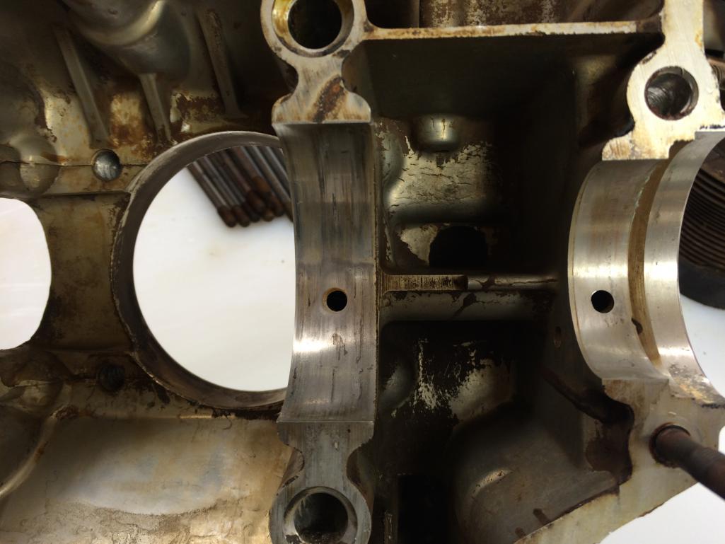

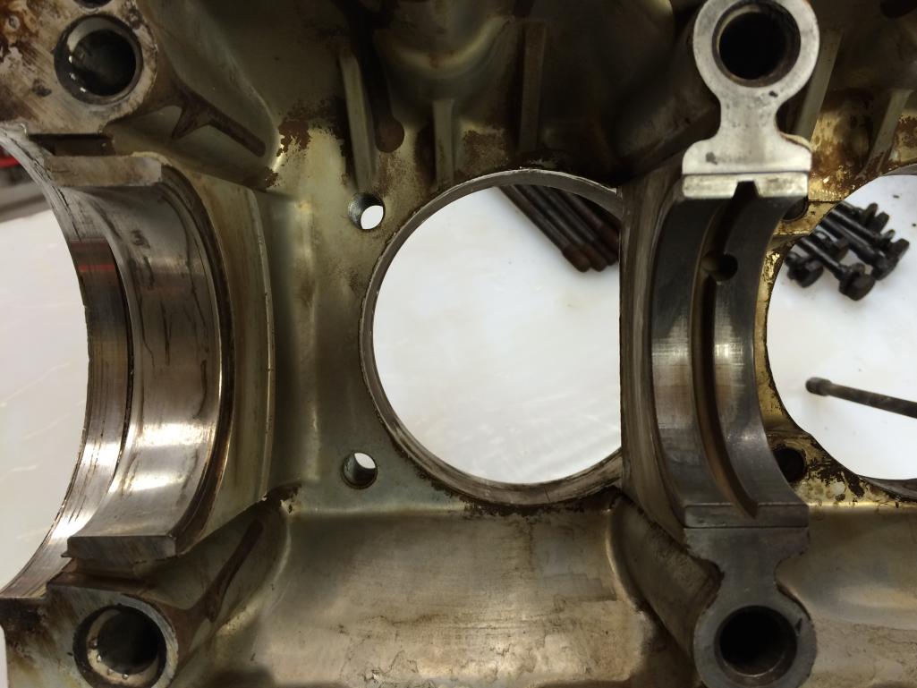

sdoolin   Today's progress. Cleaned case halves (to the ...   Jan 17 2016, 06:15 PM
sdoolin   Unusual damage to #4 cylinder deck. I must not be ...   Jan 17 2016, 06:19 PM
sdoolin   Case halves don't look too too bad...   Jan 17 2016, 06:23 PM
