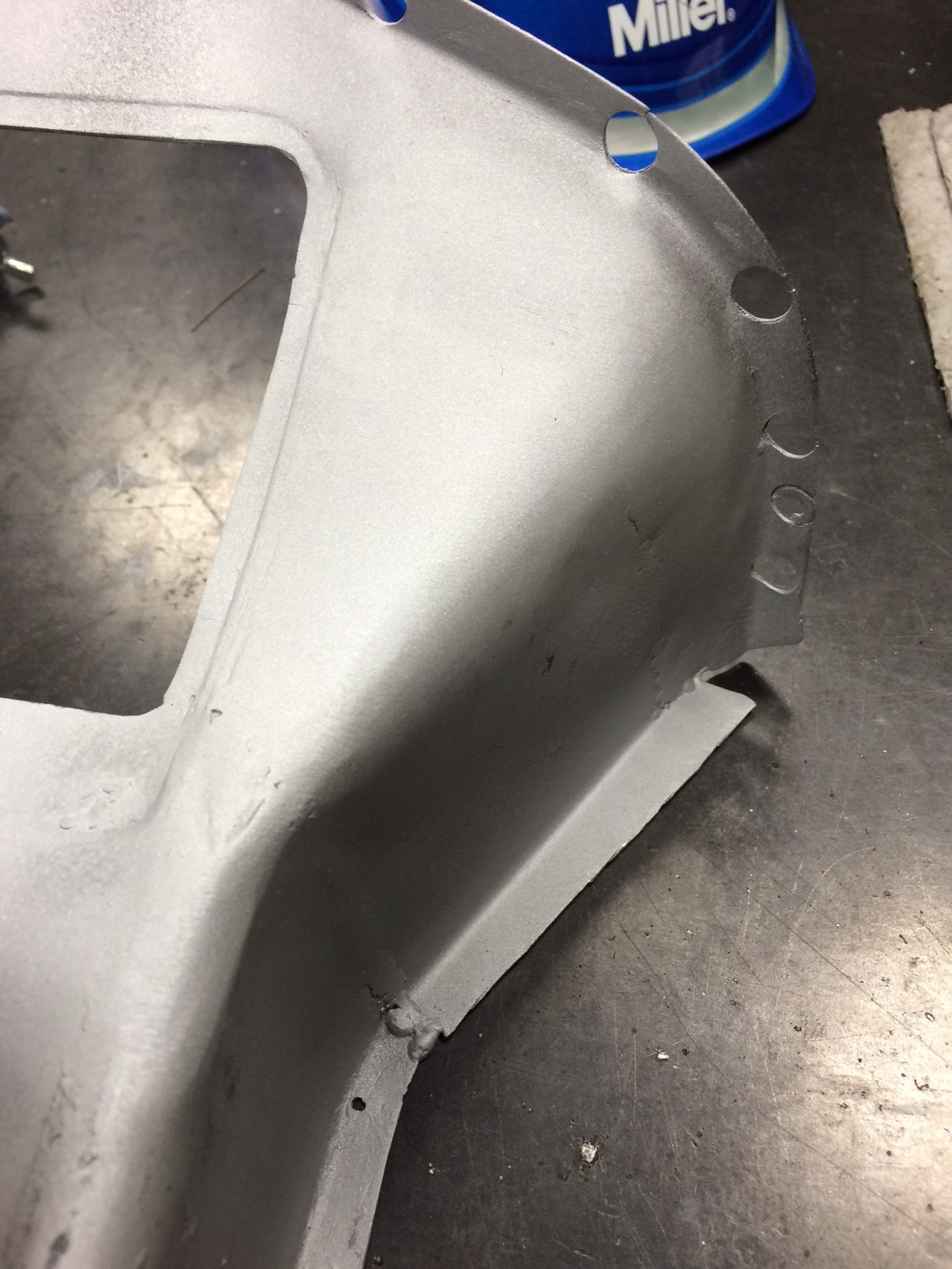

tygaboy
post Jan 17 2016, 06:26 PM
Posts: 5,803
Joined: 6-October 15
From: Petaluma, CA
Member No.: 19,241
Then I decided to get fancy and I broke out the HF hole punch / flange tool and did my best to replicate the indent for the access cover. Not quite to the point that I'll be quitting my day job but I feel like I'm getting there re: the quality level I'm trying to achieve.
Still have a few touch ups but this was it for today.

tygaboy   Little bit of :welder: and the front floor half i...   Jan 16 2016, 06:42 PM
tygaboy   Part of the floor repair includes a fix to the tun...   Jan 17 2016, 06:17 PM
tygaboy   Next, I had to fab the patch. Different radius on ...   Jan 17 2016, 06:19 PM
tygaboy   rough cut the patch, figure where the radius needs...   Jan 17 2016, 06:20 PM
tygaboy   Ta da. Just like I'd hoped!   Jan 17 2016, 06:21 PM
tygaboy   Trim, fit, trim, fit, trim, fit... then :welder: ...   Jan 17 2016, 06:23 PM
Cracker   :trophy: Great job! Bummer about the "C...   Jan 17 2016, 06:26 PM
tygaboy   Then I decided to get fancy and I broke out the HF...   Jan 17 2016, 06:26 PM
