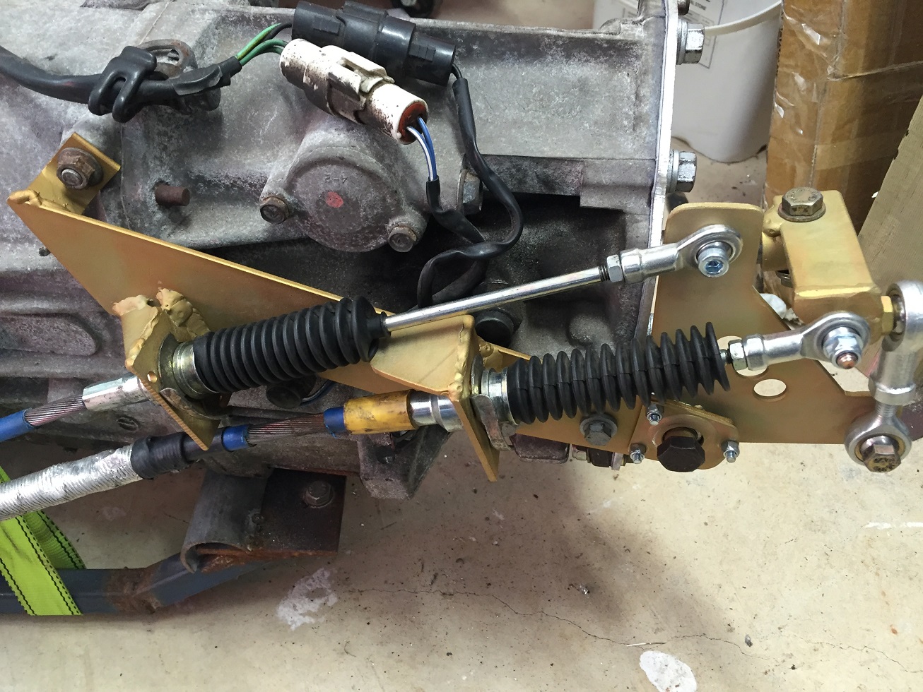

also, what took AGES was the shifter linkage - using a lotus elise shifter tunnel & cables I measured, then measured more, then mocked up, then tore apart, then mocked up again and finally completed it ... it works perfectly ! as you can see from the pic, I also modified the gearbox for 2wd & made a rear plate. I do already have a gearbox that I did the 2wd mod on, its a slightly older box tho and theres no harm in keeping a spare (IMG:style_emoticons/default/smile.gif)
you can see the bottom of the L shaped part is the pivot point, this has a sealed ball bearing in there for nice free movement - I made the cap for it by using a hydraulic hole cutter, but inverting the cutter part, using it as a press to shape a piece of metal to cover the flange in the bearing and keeping it in place. (pic of the press attached) it works extremely well - the other idea was to use a bearing flange, as per the 3rd pic, which I still have as an option if this doesn't work out ...
I obviously also have had good use of out the zinc plating kit (IMG:style_emoticons/default/smile.gif)
