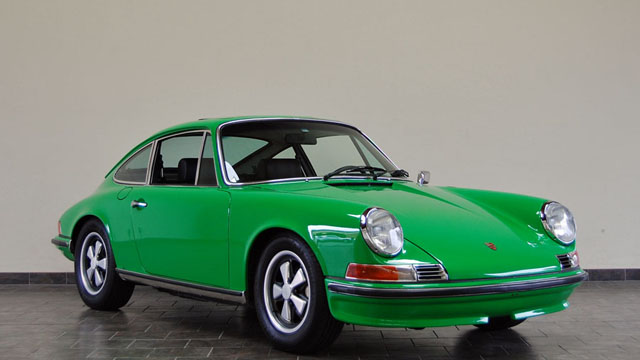

THIS is Viper Green:
Your 914 would look good in this color!!!!
