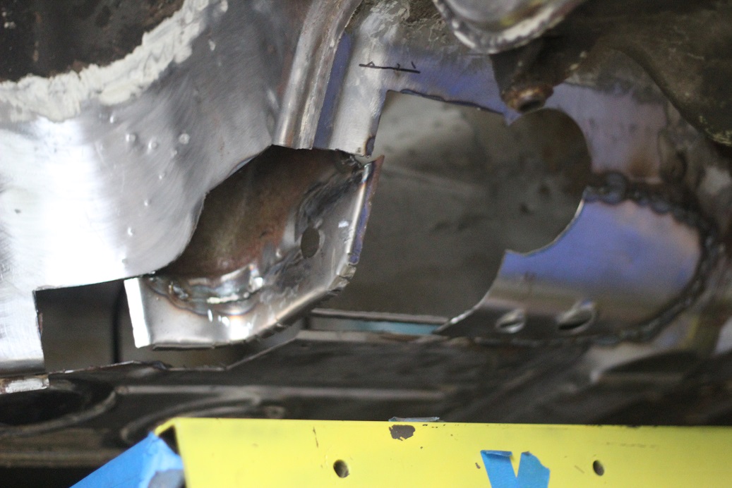

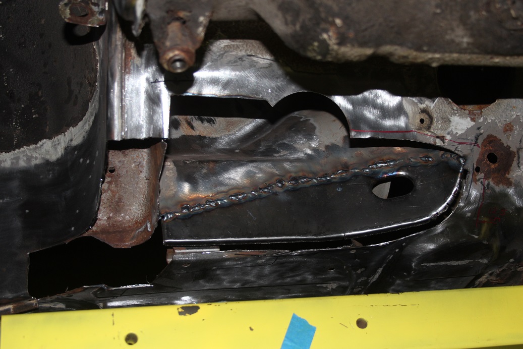

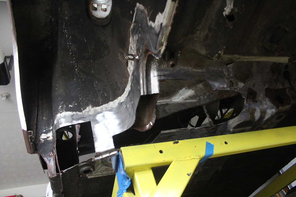

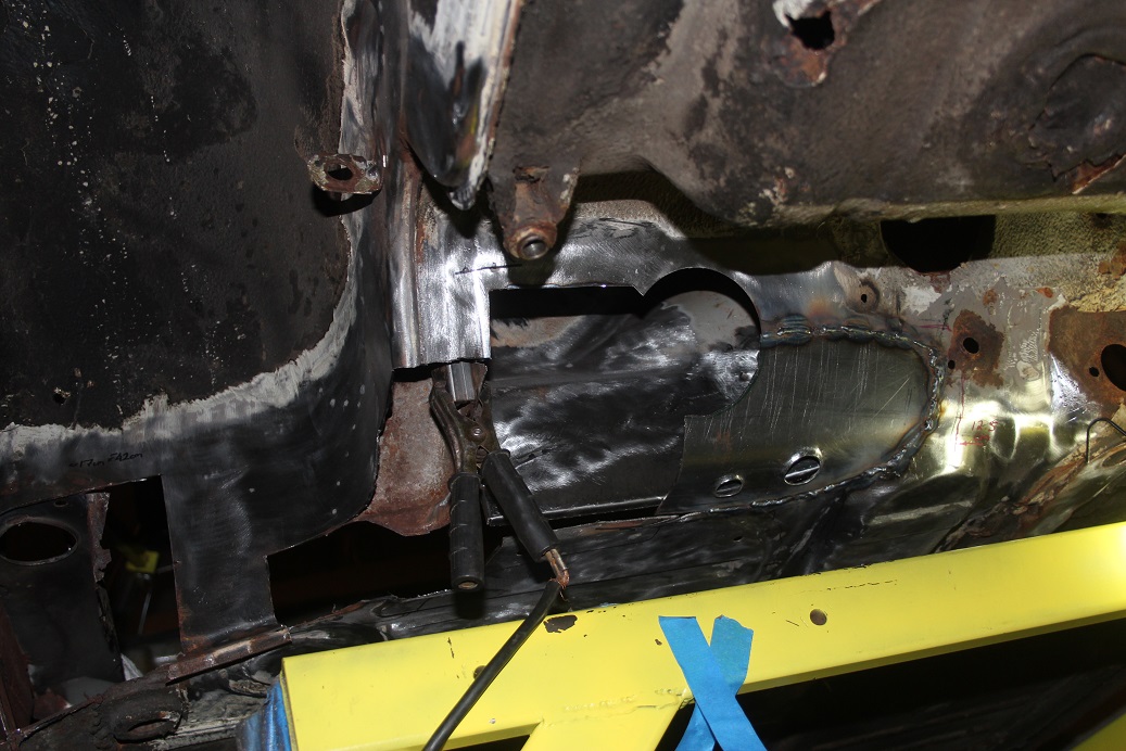

Time to catch you guys up... Spending some cold January Saturdays with my butt planted on the concrete floor. Love the welding, agnostic on the grinding.
I had a pile of patches that I made in December, all ready to weld in.
Started the month with a big part of the wheel-well/steering-tunnel cut away.
Here's the first patch in the firewall, from the outside and from the inside:
Second patch in the tunnel:
Third patch completes the box section that reinforces the area where the tunnel meets the wheel well:
Fourth patch to complete the steering tunnel:
