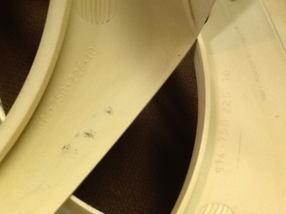

Garland   Just noticed that one set has part numbers, I thin...   Jan 24 2016, 09:51 AM
