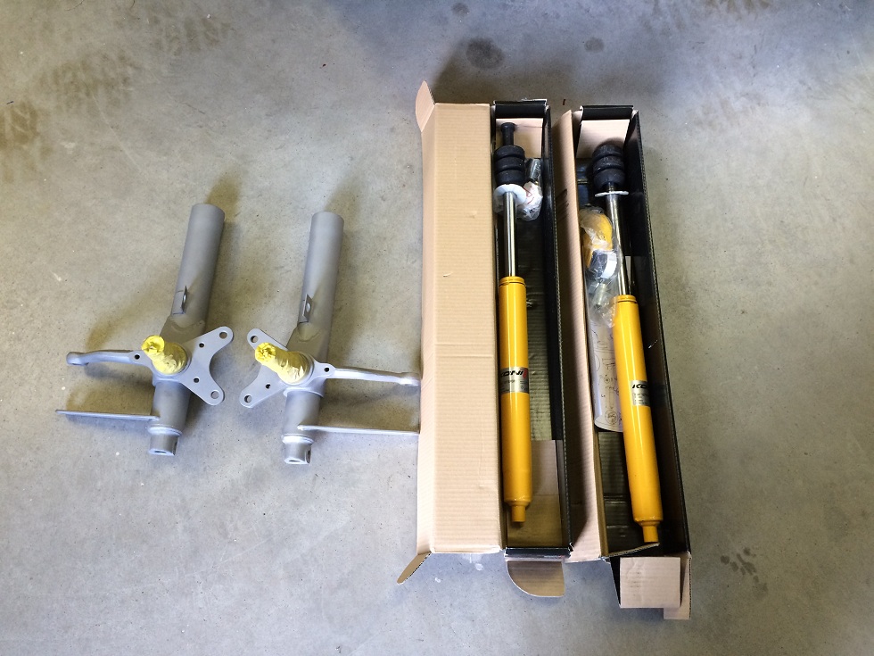

As mentioned, I'm working with Rich Johnson on a suspension package and it's almost done. So here's a little suspension porn to start the week!
Raised spindles, Koni yellows. Not pictured are the Boxster calipers. Can't hardly wait! (IMG:style_emoticons/default/piratenanner.gif)
