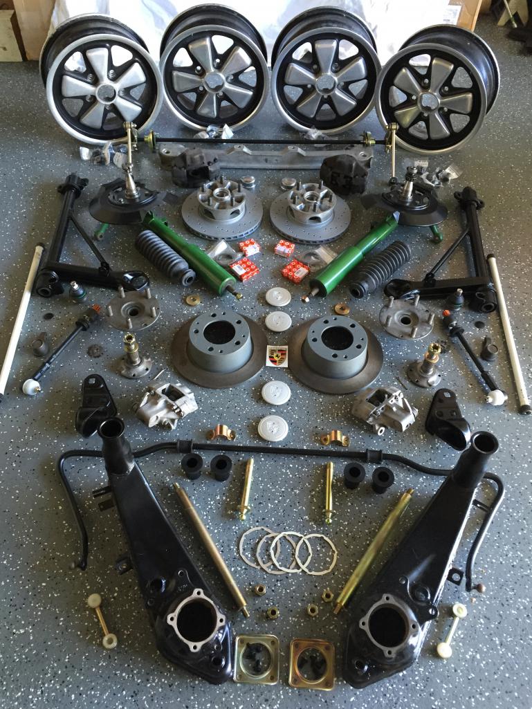

My suggestion is to find a local place in an industrial park that will work with you. Our local place isn't pretty and my order isn't typical (they mostly do patio furniture and aluminum awnings). $275 got all this done and my 914-6 tank. Everything looked like crap on the way in.

Do it right if you are going to do it. Powder coat is the way to go. I'm actually picking up more pieces today at my p/c shop.
